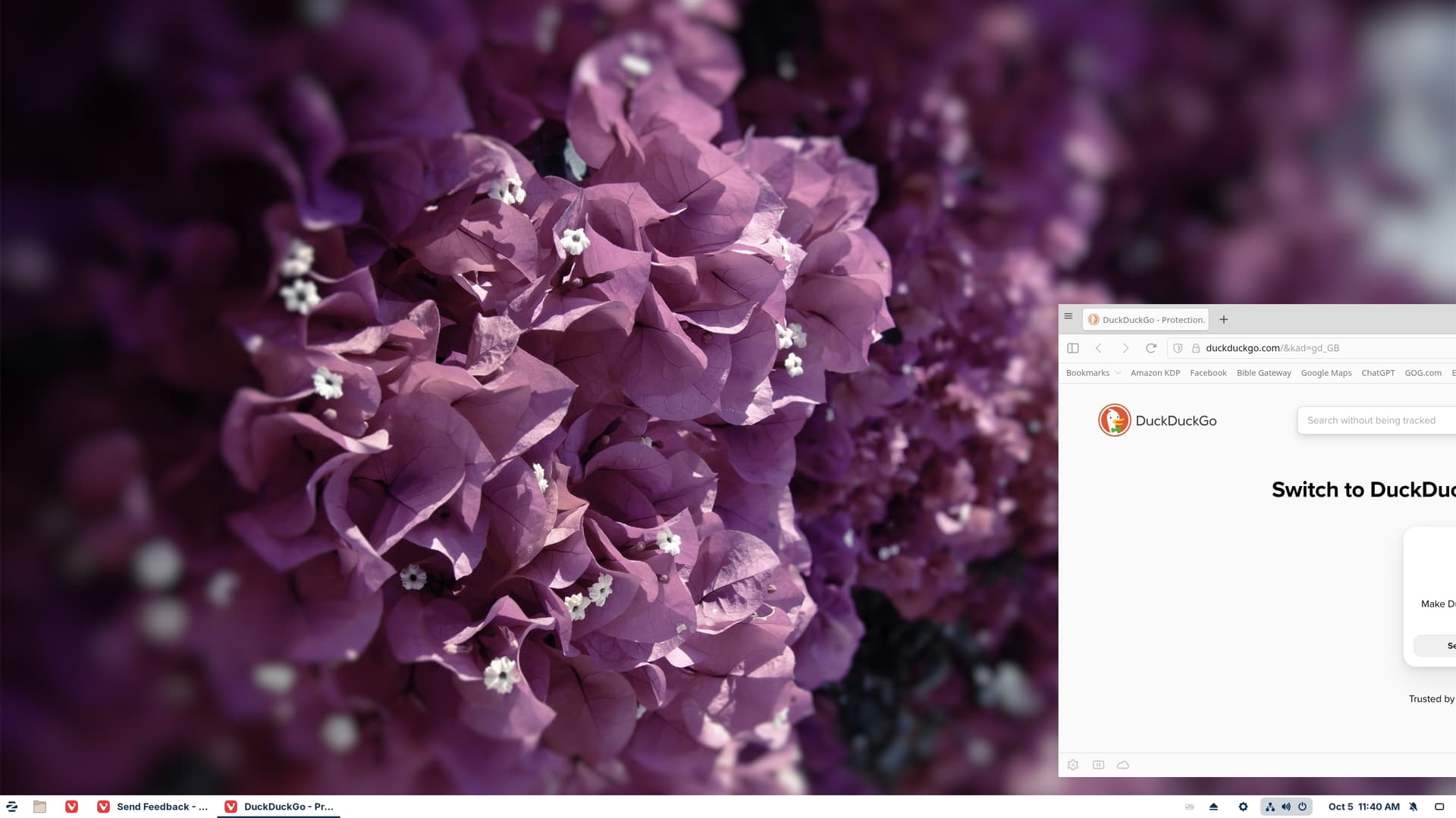

At the risk of sounding dramatic, the latest update of Zorin broke a few things for me. Every time I open my browser (Vivaldi), it now opens slightly off-screen, so I have to double click the top bar to maximize it. It also broke the transition from my 1440p monitor to my 1080p TV. It used to be able to change the audio input automatically, but now I have to manually change it every time I switch to my TV and back to my monitor ... which is REALLY annoying. I have a feeling these two issues are related, but I don't know how to fix them. I also have an issue with those stupid keyrings every time I open my browser after a restart. I literally have to type a key ring in three times to open the browser. I don't know why this is a thing, but it's also really annoying. I looked up how to change it, and it (sort of) worked for a while, but now it's doing it again. These are all mostly minor bugs, but they do add up to make it frustrating experience.

I tried using the centre new windows feature in Zorin Appearance, as well as the "Spread" function, but no such luck. It seems clear that this is somehow tied to the resolution of my TV and monitor, since Zorin seems to struggle switching between two different displays (especially if they are different resolutions).
This is what's happening when I open my browser.
