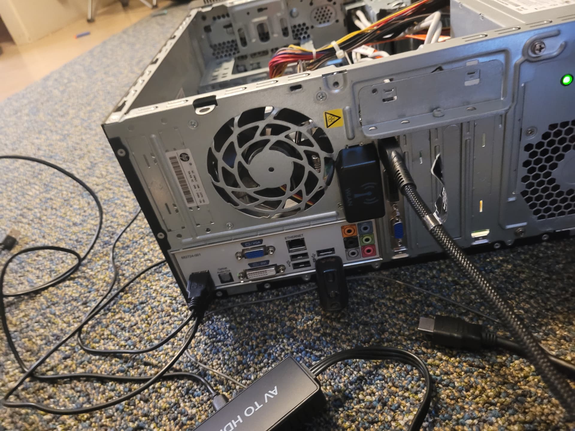

I apologize if the title is too Crass. I am trying to Zorin core to run on it entirely, but it won't run after I changed the BIOS Boot Order it's a HP. I cannot enter BIOS, or Desktop to display. I have a friend who plans on getting it a VCA cable to get it to maybe use the internal graphics to display. The fans on everything turn on, but no one is home. It went through the entire thing just fine it's when I switched to secure boot, and switched the Boot order. That is when it went from No kernel to nothing on display. I plan to take it into the Tech I know, and see if a wiser wizard can make it work, but any inputs would be greatly appreciated. I have tried getting a keyboard to work, but the keyboard aren't even being powered on.

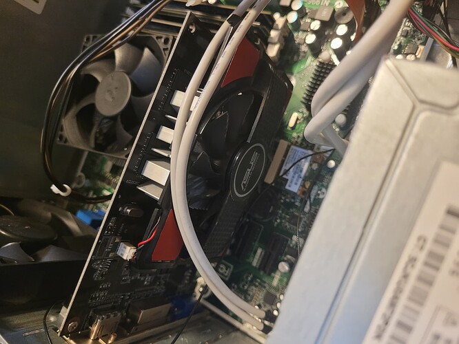

Graphics: GT740
Edit: Added Photos
Any hope?

Your graphics card is probably the issue. Starting afresh I would boot into live mode (Try Zorin) and run the Boot Repair utility so that you get a GRUB menu with a timeout of 10 seconds. Alternatively to get to GRUB menu with your machine in it's current state I would try pressing the Esc(ape) key repeatedly or left shift key repeatedly to get GRUB menu.

Your nvidia card needs older nvidia drivers for Linux which don't ship with modern distros, it needs the 390 drivers.
