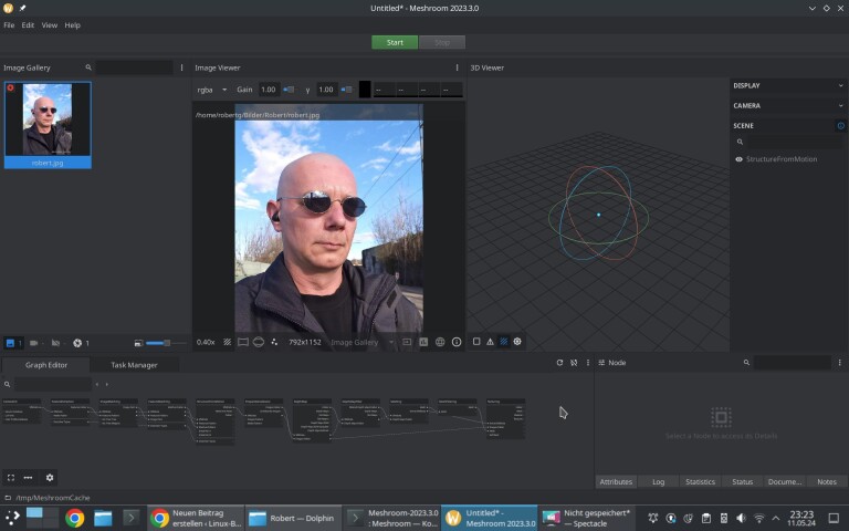

I have Zorin 17.3 OS. I have downloaded an extracted Meshroom 2023.3.0. but can not get it running. Any idea what should I do?

Now I get this fault:
Warning: Ignoring XDG_SESSION_TYPE=wayland on Gnome. Use QT_QPA_PLATFORM=wayland to run on Wayland anyway.
qt.qpa.plugin: Could not load the Qt platform plugin "xcb" in "" even though it was found.
This application failed to start because no Qt platform plugin could be initialized. Reinstalling the application may fix this problem.
Available platform plugins are: eglfs, linuxfb, minimal, minimalegl, offscreen, vnc, wayland-egl, wayland, wayland-xcomposite-egl, wayland-xcomposite-glx, webgl, xcb.
What that's telling you is that it's having an issue running on Wayland. Have you tried running on Xorg instead? At the login screen, when you're typing in your password, a cog should show up in the bottom right corner. You can click it, then select "Zorin on X" and then login as normal.
I don't have this option
If you do not see it, select as if to "log in as another user"
Then it should appear.
After selecting the gear icon /cog wheel and changing to Xorg, you can then log in normally as your normal user account.
