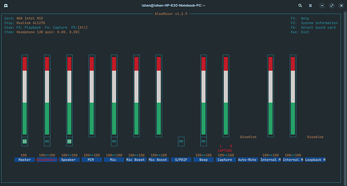

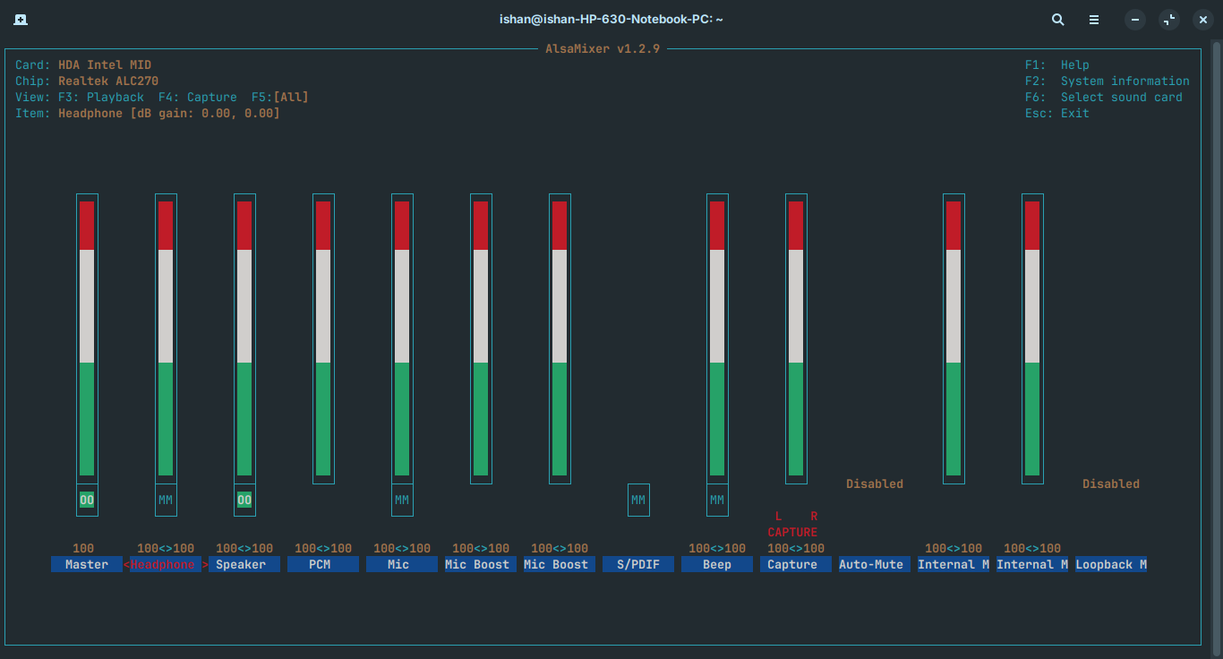

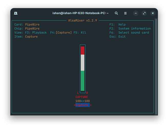

the mic previously worked in chrome os and windows however whenever i switched the only bug was that the mic was dead or makes loud noises out of no where. i think this realtek card always bugs with linux

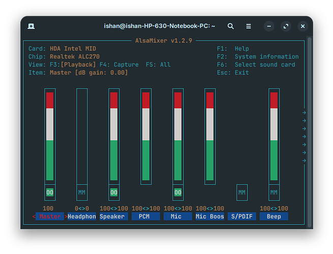

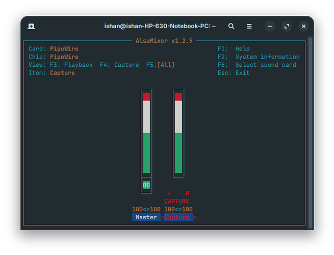

In your last screenshot is the microphone (Mic) chanel shown as MM=muted. Try to select this chanel and press the m key to unmute it. It should show 00.
edit: thanks for the reply:D
i turned the value 00 of Mic as you mentioned and the results are unchanged :,(

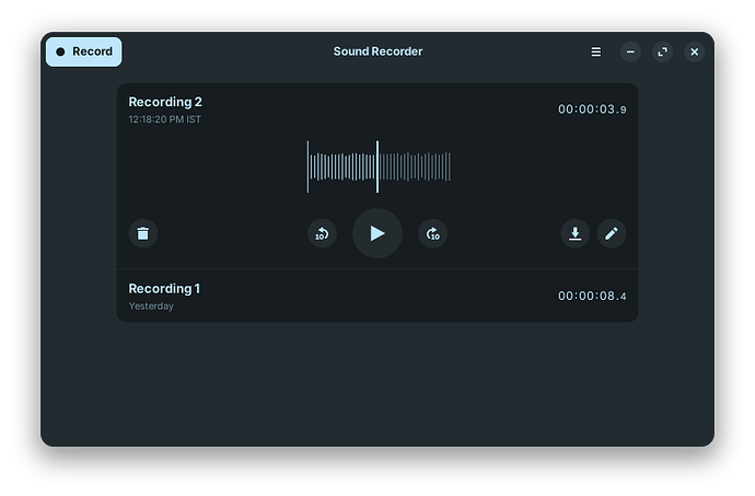

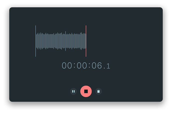

i entered the command it showed usb then nothing and i recorded again but the results are unchanged:(

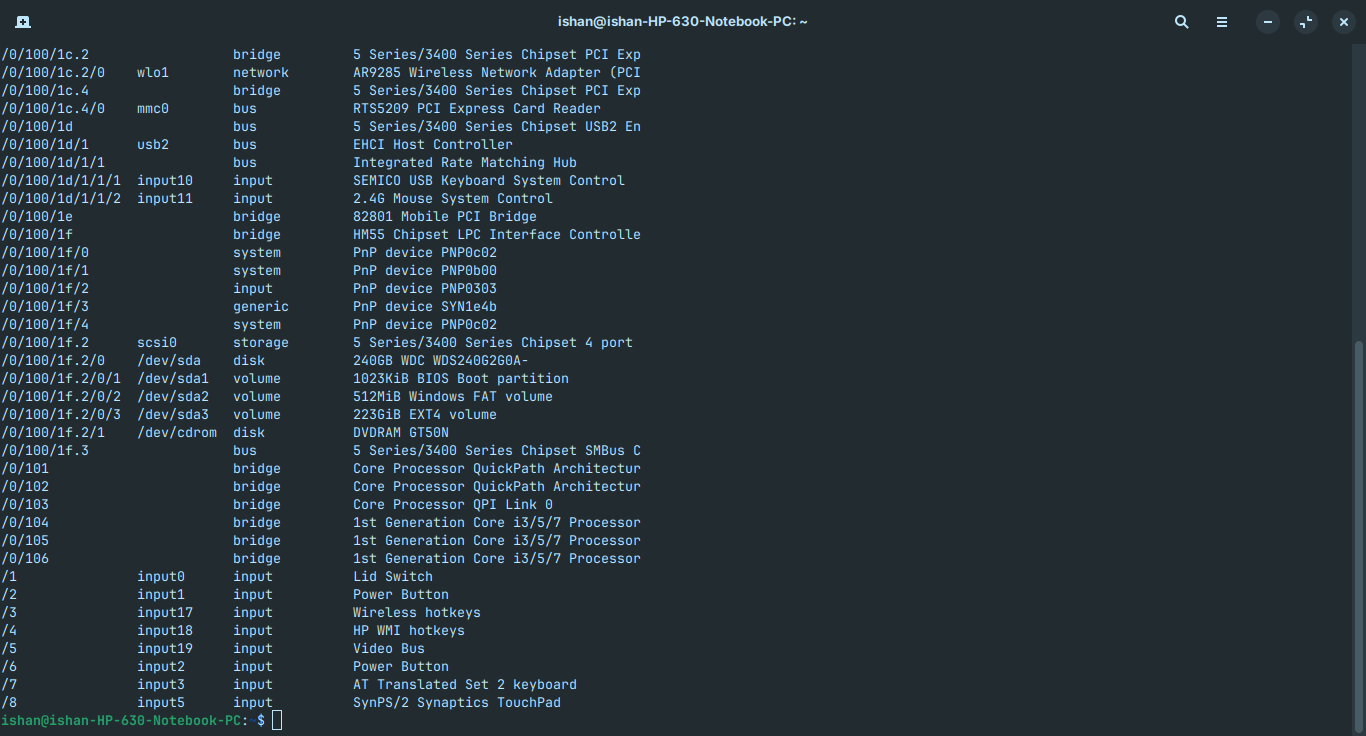

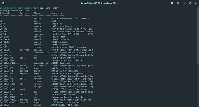

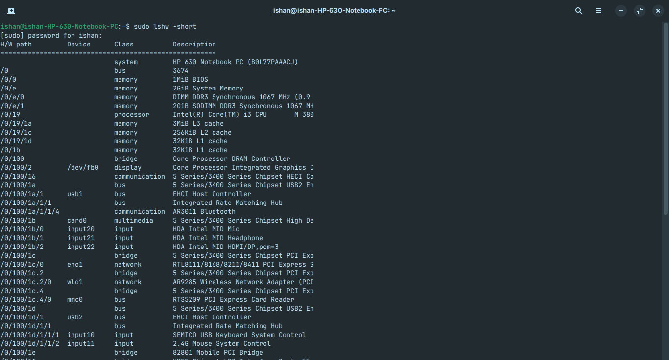

OK, let's go the whole hog:
sudo lshw -short
pushed the command showed me the following:
