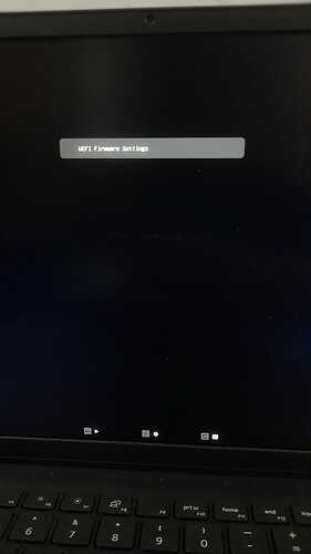

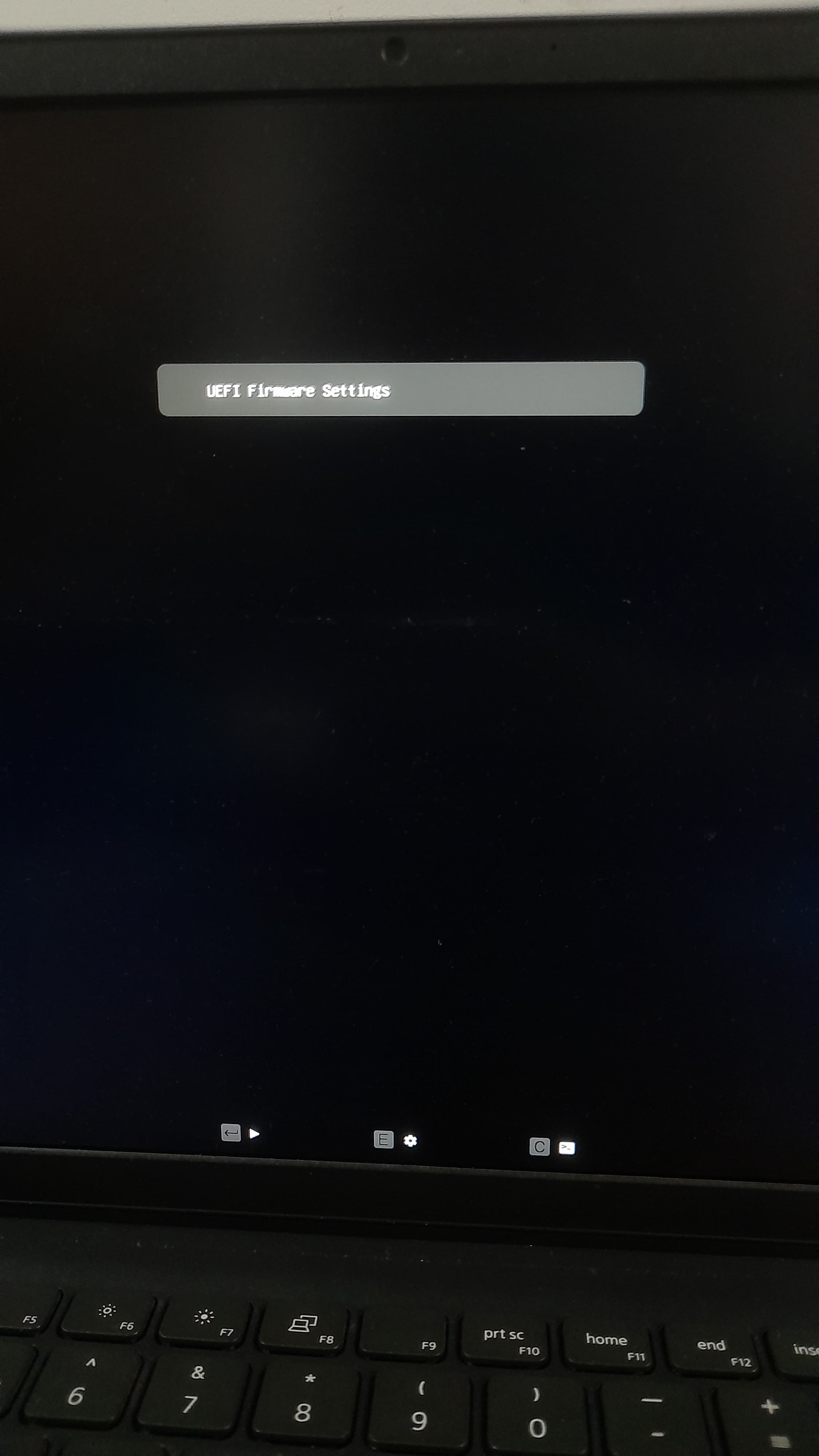

My Dell Inspiron 15 ran into a problem when Windows shows a Recovery screen said that is something went wrong. So I purposely removed both Windows Boot Manager and Zorin OS from a boot settings,
ran a boot repair from live USB, and the result only UEFI Firmware Settings is shown on GRUB boot menu and not including both Windows Boot Manager and Zorin OS.

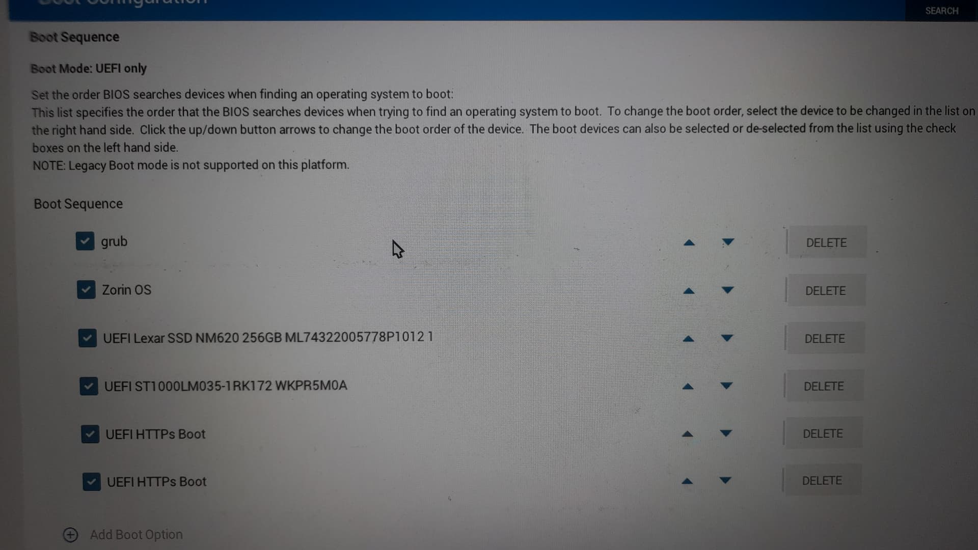

When You set ''Zorin OS'' and first Position on ''Boot Sequence'' does it work?
As it is now booting to a Zorin-themed grub screen, the bootloader exists but is missing configuration.
You can boot Super Grub2 Disk from USB to list all bootable partitions and OS on your PC, get into your actual Zorin install instead of the Zorin live USB:
(either download the first option under USB Bootable Images and write directly to USB, or the first option under CD-ROM Bootable Images to add to a Ventoy stick if you have that set up)

It sounds to me as if it was your removing the two boot options that caused the issue, not the boot repair. I don't understand why you removed them but that is not relevant. I don't think you actually removed the boot loaders themselves, just stopped BIOS from booting from them. Reinstalling should not be necessary.
I assume you cannot get back to the screen in your first screenshot to add them back. Is that a windows screen?
You should be able to do something similar in your BIOS itself. You might get to it by clicking or hitting enter on the one remaining choice on the grub screen, or by repeatedly pressing the appropriate key (esc?) after turning power on.
Not at all. It is still the same.
Do you mean with that:
You have deleted the Boot Partitions or only set them down in the Boot Priority?
Boot Priority

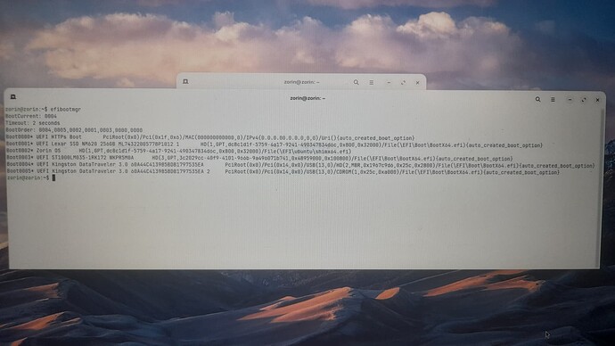

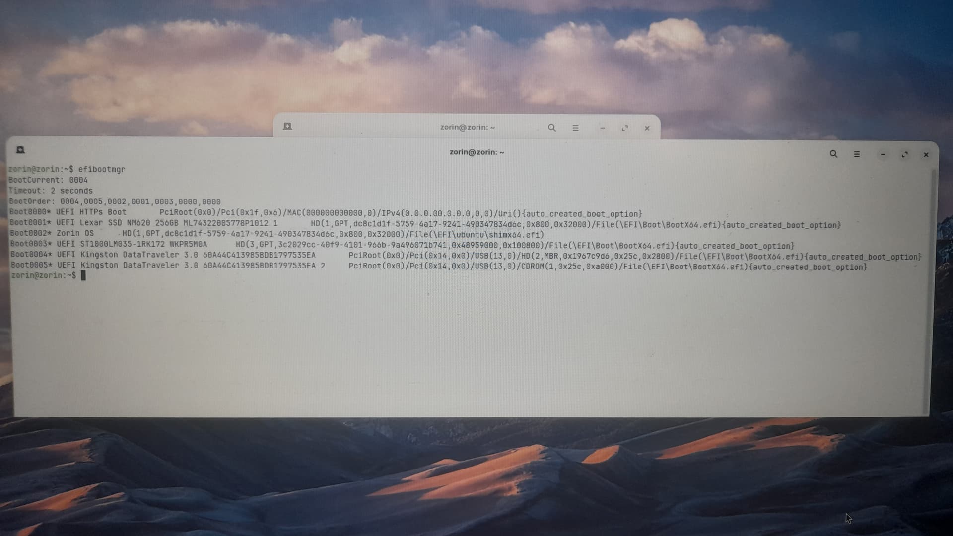

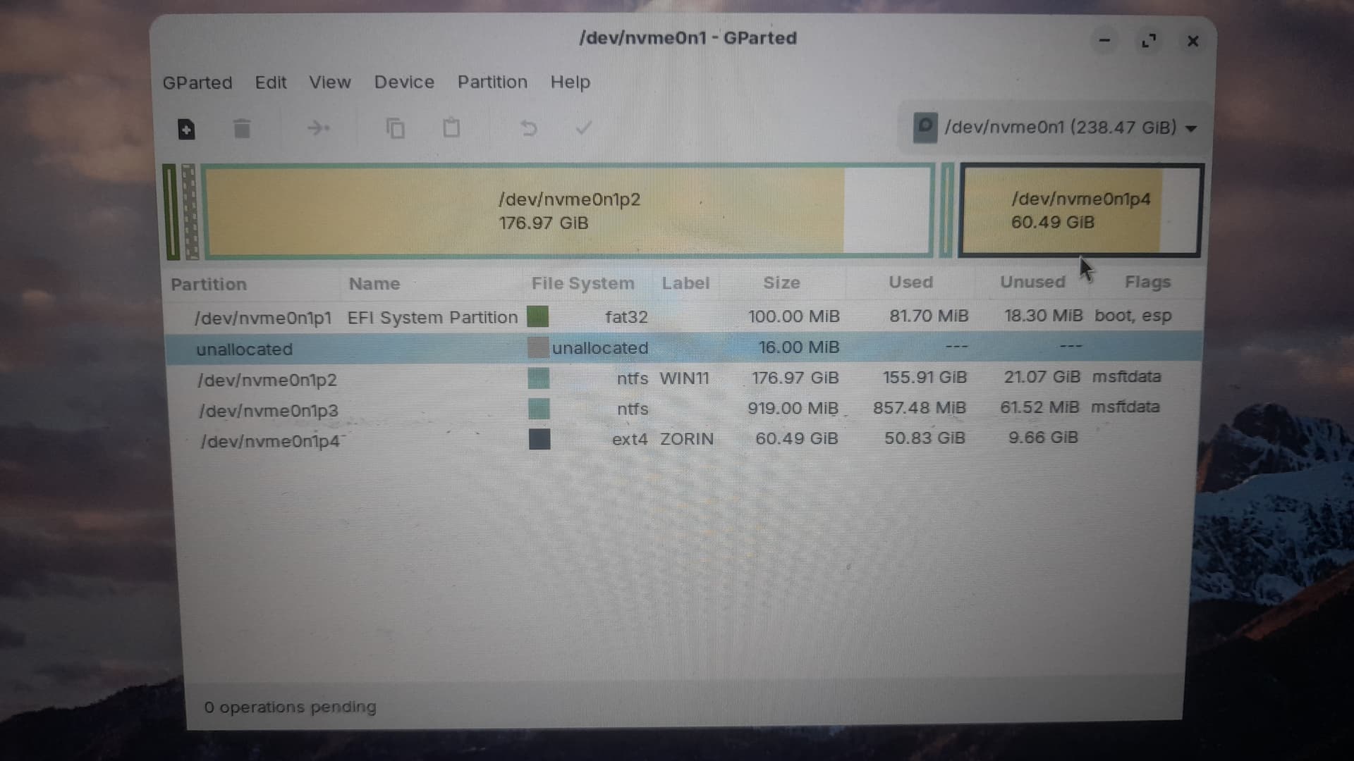

Hmm ... Okay, start Zorin from the Bootstick in Live Mode. Look there for ''GParted'' and start it and make a Picture of the Partitions and post it here please.
Here are my partitions.
Okay, the Partitions look good. The EFI-Partition is still there, too. Please try again Boot Repair from the Live Mode.
Just did a boot repair. Here is a report:
boot-repair-4ppa2081-zorin1 [20260830_1249]

BootCurrent: 0004
Timeout: 2 seconds
BootOrder: 0004,0005,0002,0001,0003,0000,0000
Boot0000* UEFI HTTPs Boot PciRoot(0x0)/Pci(0x1f,0x6)/MAC(000000000000,0)/IPv4(0.0.0.00.0.0.0,0,0)/Uri(){auto_created_boot_option}
Boot0001* UEFI Lexar SSD NM620 256GB ML74322005778P1012 1 HD(1,GPT,dc8c1d1f-5759-4a17-9241-490347834d6c,0x800,0x32000)/File(\EFI\Boot\BootX64.efi){auto_created_boot_option}
Boot0002* Zorin OS HD(1,GPT,dc8c1d1f-5759-4a17-9241-490347834d6c,0x800,0x32000)/File(\EFI\ubuntu\shimx64.efi)
Boot0003* UEFI ST1000LM035-1RK172 WKPR5M0A HD(3,GPT,3c2029cc-40f9-4101-966b-9a496071b741,0x48959000,0x100800)/File(\EFI\Boot\BootX64.efi){auto_created_boot_option}
Boot0004* UEFI Kingston DataTraveler 3.0 60A44C413985BDB1797535EA PciRoot(0x0)/Pci(0x14,0x0)/USB(13,0)/HD(2,MBR,0x1967c9d6,0x25c,0x2800)/File(\EFI\Boot\BootX64.efi){auto_created_boot_option}
Boot0005* UEFI Kingston DataTraveler 3.0 60A44C413985BDB1797535EA 2 PciRoot(0x0)/Pci(0x14,0x0)/USB(13,0)/CDROM(1,0x25c,0xa000)/File(\EFI\Boot\BootX64.efi){auto_created_boot_option}

Disk nvme0n1: 238.47 GiB, 256060514304 bytes, 500118192 sectors
Disk identifier: B4873B0D-178B-4DF6-90DE-D4C1BE10F968
Start End Sectors Size Type
nvme0n1p1 2048 206847 204800 100M EFI System
nvme0n1p2 239616 371381704 371142089 177G Microsoft basic data
nvme0n1p3 371382272 373264383 1882112 919M Microsoft basic data
nvme0n1p4 373264384 500117503 126853120 60.5G Linux filesystem

Do you see Zorin or Windows in your grub menu now?
Does it worked?
not at all.
Okay ... Let's check a different Thing. I'm not sure if this works in Live Mode, but we can try. When in Live Mode open the Terminal and type efibootmgr and post the Output here please. It gives or should give an Overview about the Boot Files in more Details.
modprobe: FATAL: Module efivars not found in directory /lib/modules/6.17.0-20-generic
grub-install: warning: EFI variables cannot be set on this system.
grub-install: warning: You will have to complete the GRUB setup manually.
Warning: NVram is locked (Zorin not found in efibootmgr).
There are some errors and warnings in there about it not being able to set EFI variables and advising you to manually configure grub, as well as locked NVram which usually indicates that the EFI partition is not writable for one reason or another. So, even though the output clearly shows it detecting Windows and Zorin, it cannot actually write their config details to your bootloader so that they show up as options.
Per my previous comment, I advise you use SG2D to boot into your actual Zorin install to run sudo update-grub there, instead of via the live ISO's boot repair tool.
You can use the live ISO to create an SG2D USB stick if you don't have another PC, though that will require you to have another USB stick lying around.
I typically recommend people use Ventoy which lets you simply copy multiple ISO and image files onto a single USB stick to boot them, instead of having to re-flash each stick every time you want to boot something different. I keep a couple of Ventoy sticks updated with various tools like SG2D, gparted, clonezilla, memtest, HBCD, etc., on top of a few Windows and linux ISOs so I'm never left stuck if my PC has a problem.
