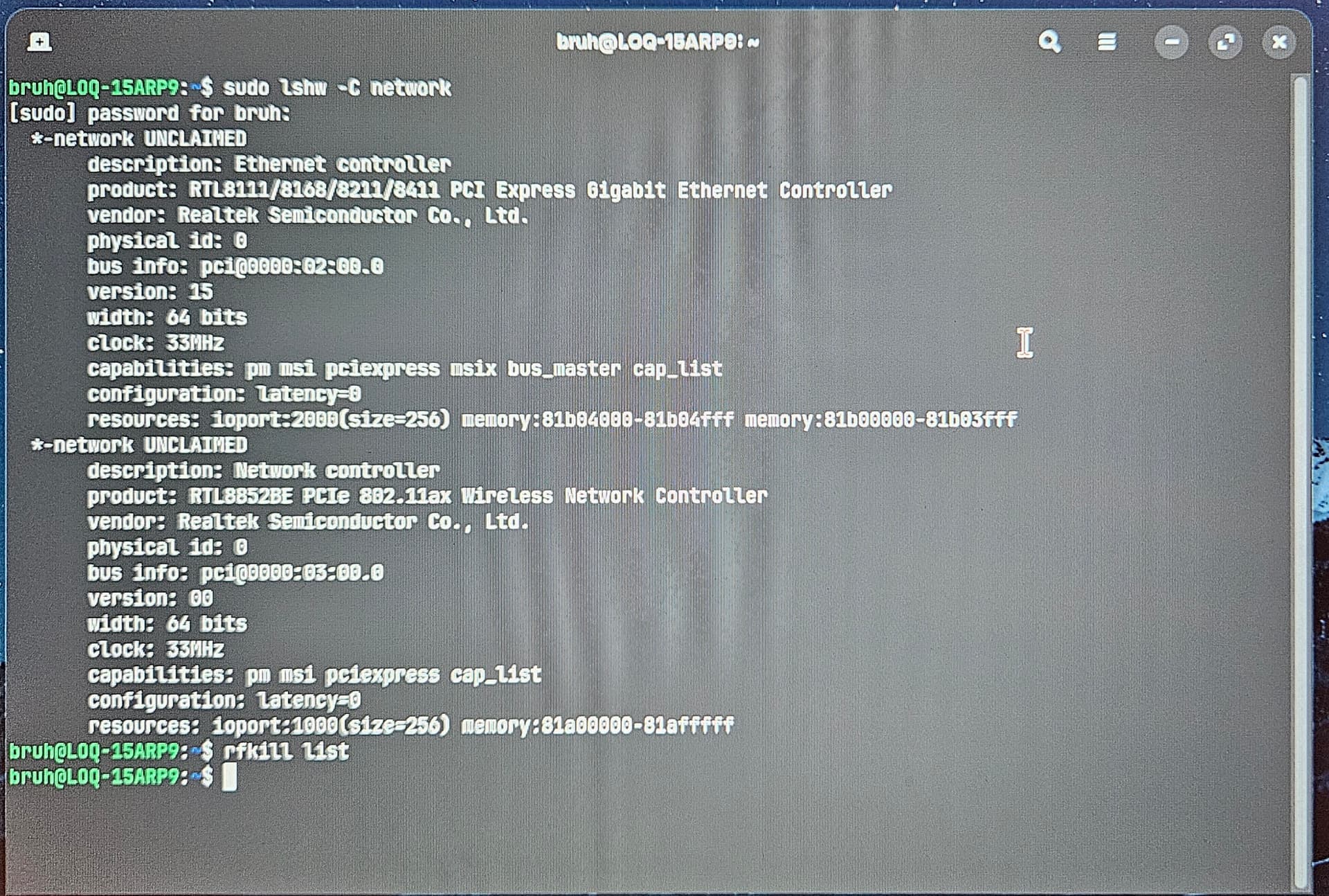

What is the terminal output of
sudo lshw -C network
and
rfkill list
? Please post it here.

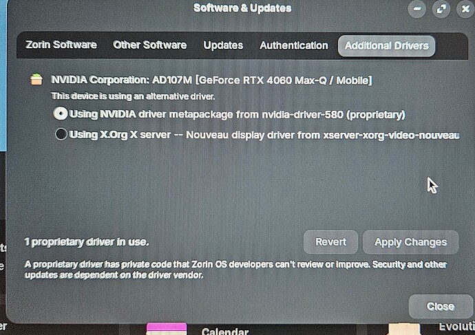

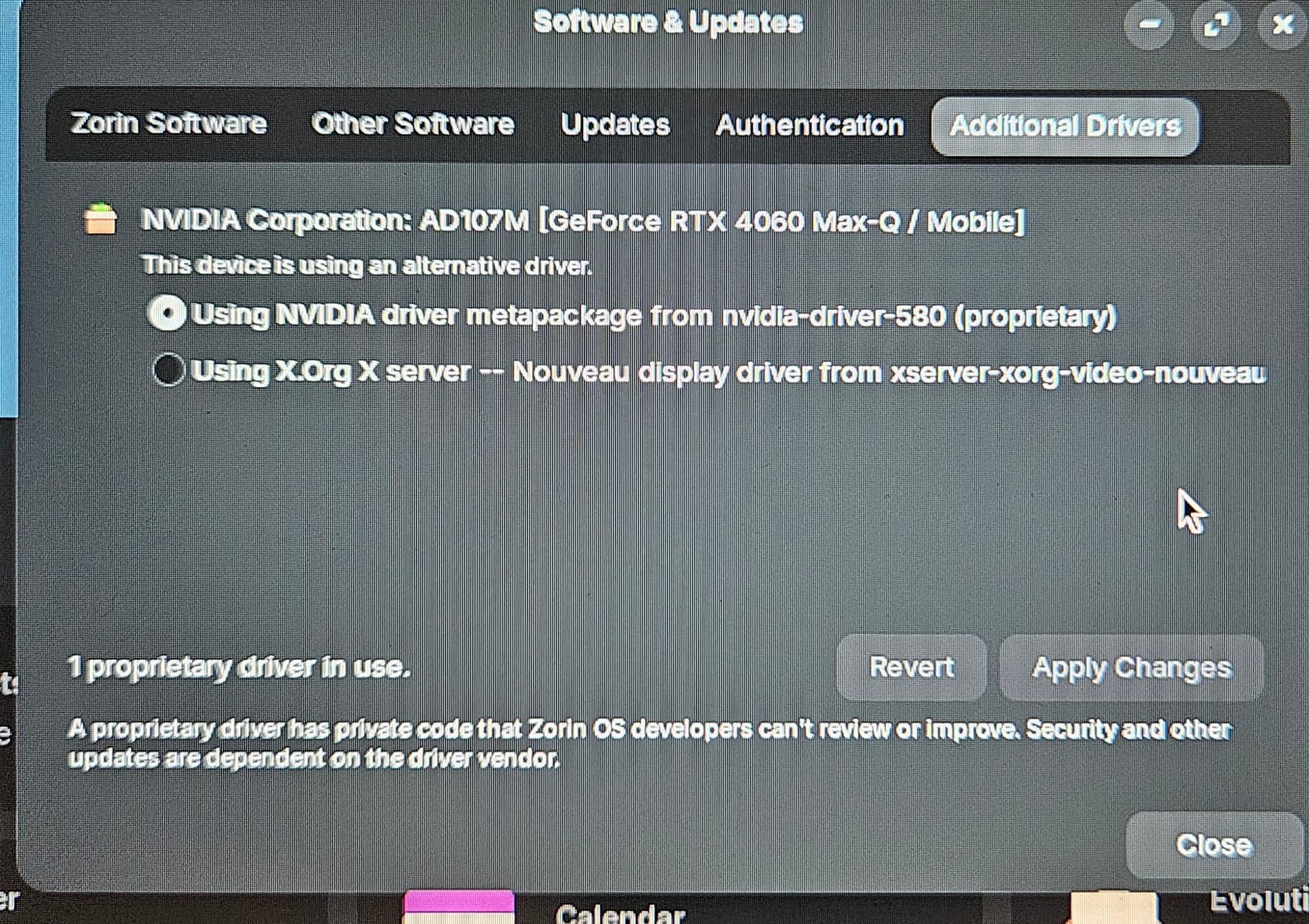

Take a look if a network driver is offered at Software&Updates >Additional drivers.

I made sure fast startup is off in both windows and my bios settings, and yes I actually do have USB tethering. Here are the outputs of those commands. It looks like the Nvidia driver is the only one that shows up in the additional drivers tab.

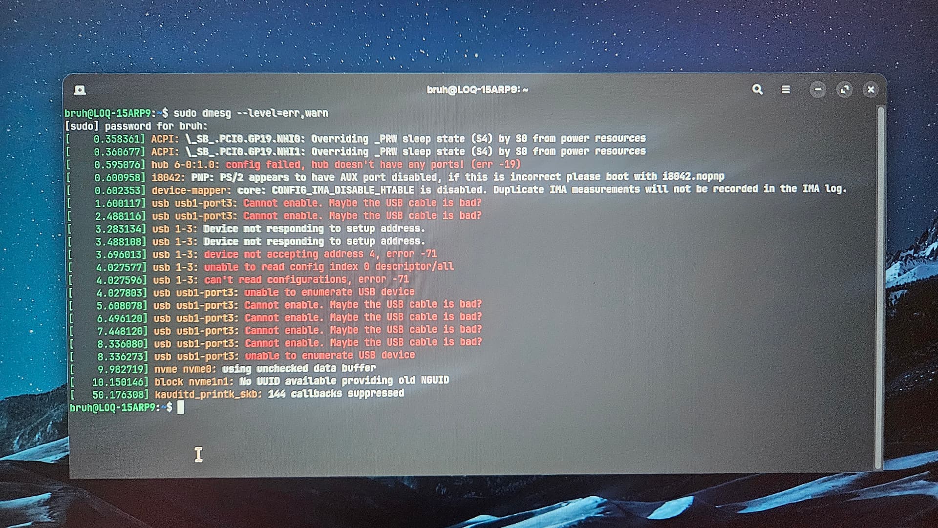

Maybe boot logs give us a clue
@Deebis try the following command and share the output:
sudo dmesg --level=err,warn
Here's what that output says, doesn't look good but I don't know what any of it means. The only usb device I had plugged in during this was a wireless mouse that is working.
I don't know if these error logs are related to your driver issue. Wait till someone else to review it.
