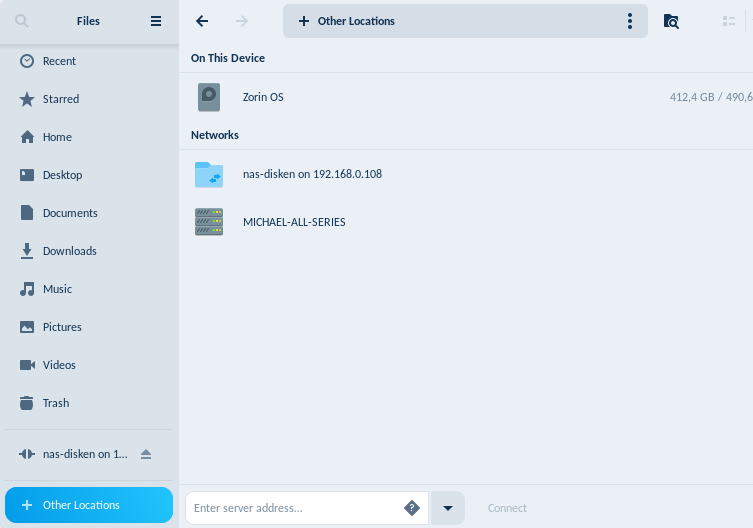

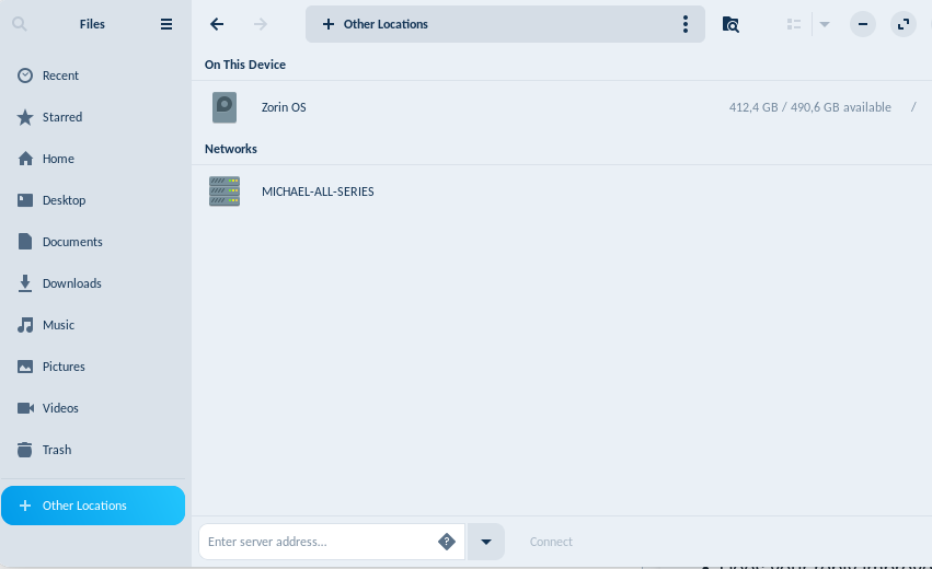

After a reboot, the NAS-drive appears only seen through DoubleCommander but not through Files?
I can not see it through "Other locations" in Files .
What is the issue?
//Michael

Yes, the mount is successful.... well I guess :upside_down_face:

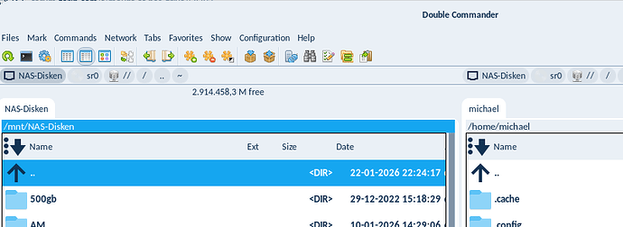

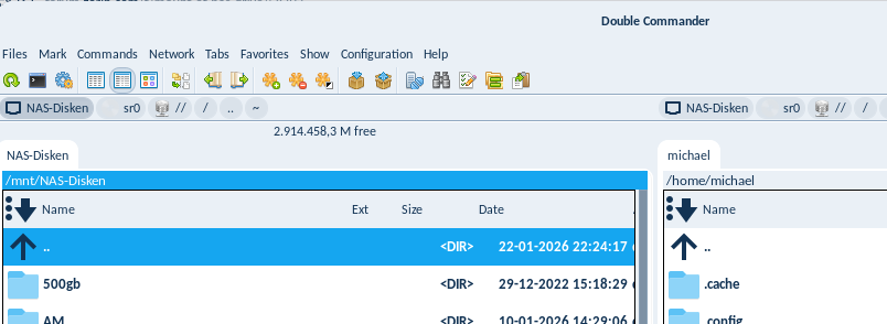

DoubleCommander sees it perfect, as it should be. No password or any other clicks.
But in Files there is nothing.
Sure in Files, I can enter the IP
...but that is not the way it should work.
I need a "real" drive and not a IP-address-path.
This manifest itself in other programs where I need to past in paths to the NAS-drive like this:
and this gives other "errors" as the program can not get access to the drive.
The funny thing is why Double Commander can see, it but the native Zorin / Files can not.

I think it is close to be so as the DoubleCommander see it as \mnt\NAS-Disken
