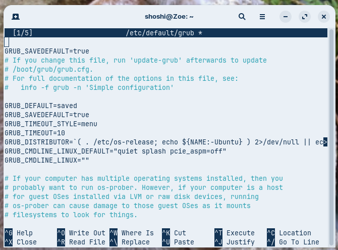

After an update yesterday, the mouse cursor disappeared again. (I checked to make sure the computer wasn't running on Wayland - it wasn't - previously I'd been told this could cause the problem). Now having the GRUB menu showing at startup, I was able to roll back to the previous kernel which worked, and then proceeded over to the Terminal as instructed in that thread, to make the change. However, when I did the next step to make it permanent, I got a different screen from before, and was not able to proceed because I couldn't understand it and didn't know what to do. I had to close the terminal, and of course next time I booted up the computer, the mouse cursor had disappeared again and I had to go through the procedure again.
Here is the screen that showed up in the terminal.

In your screenshot, you show:
GRUB_DEFAULT=saved
And GRUB_SAVEDEFAULT=true
So that all looks correct.
Make sure that you are booted into the working kernel, then in terminal run sudo update-grub'.
Upon next reboot, it should be on the earlier kernel.
Thank you, Aravisian - that seems to have done the trick! I shut down the computer and rebooted from cold, and the mouse cursor was there OK. I'll make a note of this in case it happens again.
