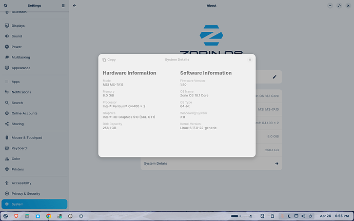

Hello guys, I am experiencing a recurring bug in Zorin OS 18.1 Core where my mouse cursor completely stops responding whenever I right-click inside Google Chrome or Brave Browser.Hey is my specs

  1. Check GPU Drivers : The MSI MS-7A15 typically supports AMD Ryzen CPUs and often paired with AMD or NVIDIA GPUs.
  • If using an NVIDIA card, ensure you are using the proprietary drivers rather than the open-source nouveau driver, which can cause cursor glitches.
  • If using AMD, ensure your amdgpu drivers are up to date via ubuntu-drivers autoinstall .
