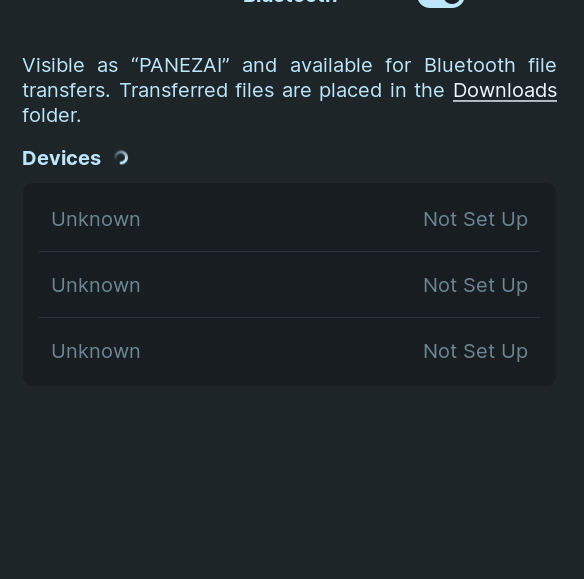

My bluetooth is open and active but not found any device
now it can find but show unknown .

yes its workng but still it can scan few devices or for few devices it shows unknown.

For devices that are still showing as Unknown, you might try installing blueman
sudo apt install blueman
and launching it to see if it recognizes devices. If that does not help, you can use the terminal:
bluetoothctl
Scan:
scan on
Pair discovered devices by ID
pair xx:xx:xx:xx:xx:xx
Connect and set to Trust:
connect xx:xx:xx:xx:xx:xx
trust xx:xx:xx:xx:xx:xx
