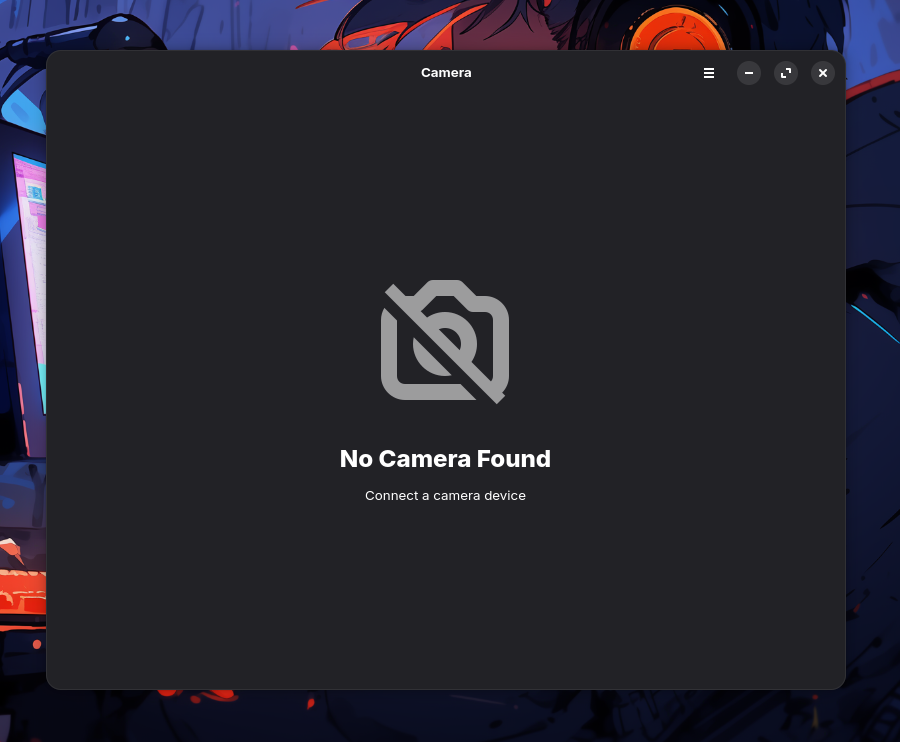

My HP victus 15 is not detecting the camera
Whenever I open the default camera app that came with the distro it is showing that camera is not detected.

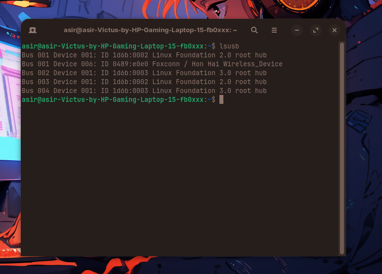

Could You type in Terminal lsusb and post the Output here please?
I tried it but no improvement

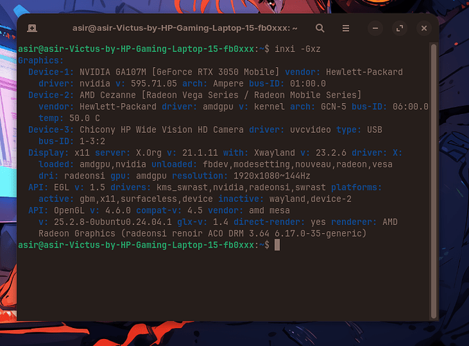

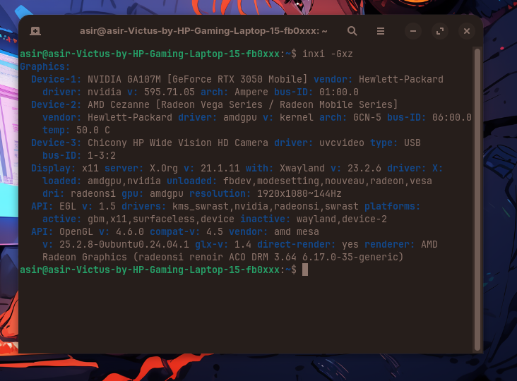

It is showing like this

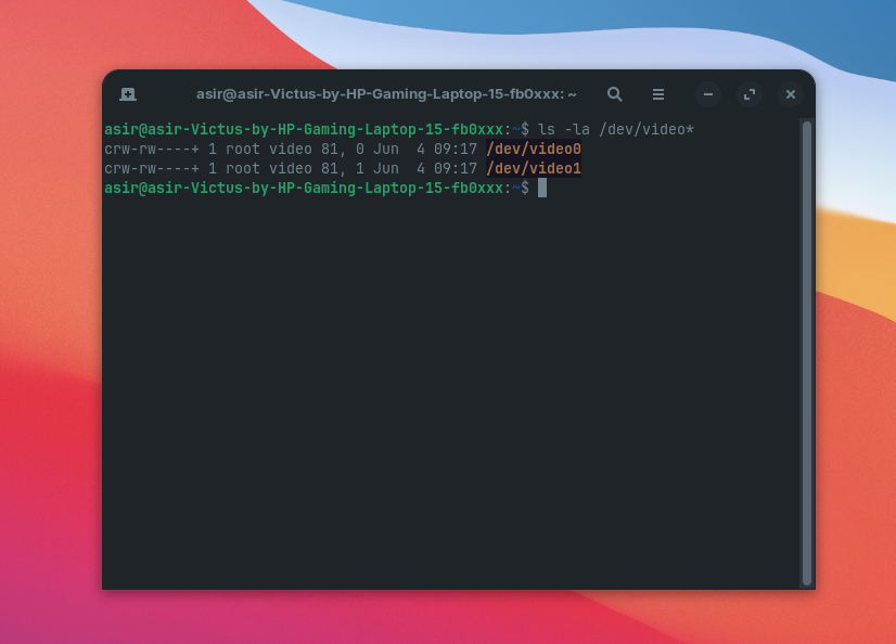

Give me the output of
ls -la /dev/video*
OK try that

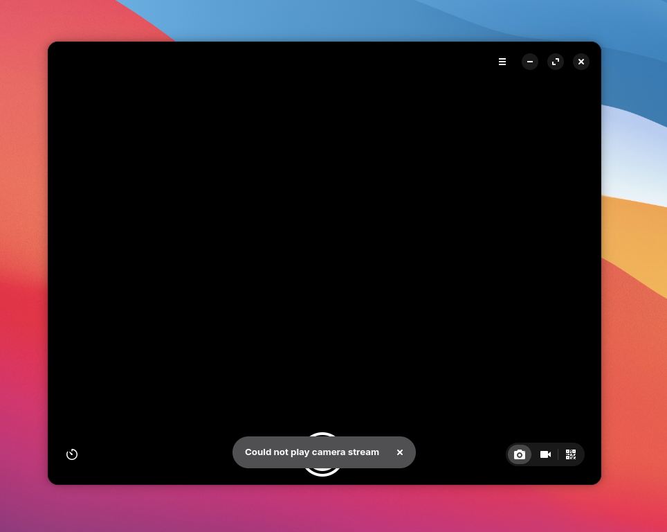

No difference

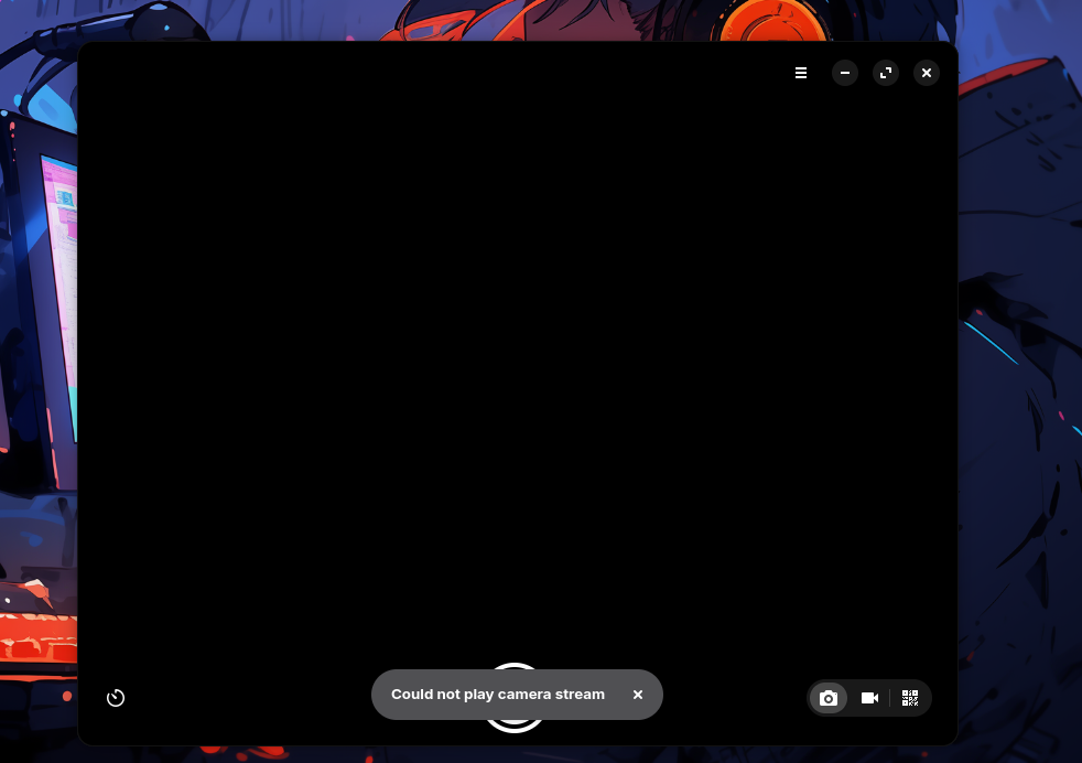

i rebooted it and checked bro but no difference
