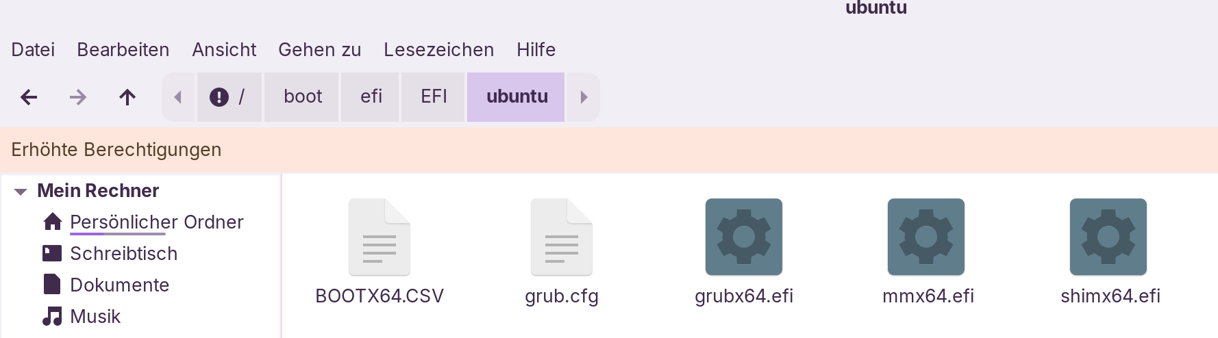

Please have a look into the folder and show us the output.
admin:///boot/efi/EFI/ubuntu
Despite the message "failed to open \EFI\ubuntu\ - not found." the folder should be there and EFI files in it. But there must be a reason that it can't access it during boot. Question to the experts: Could it help during boot to bypass the shimx64.efi and using the grubx64.efi instead and how?
