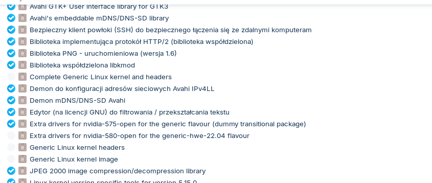

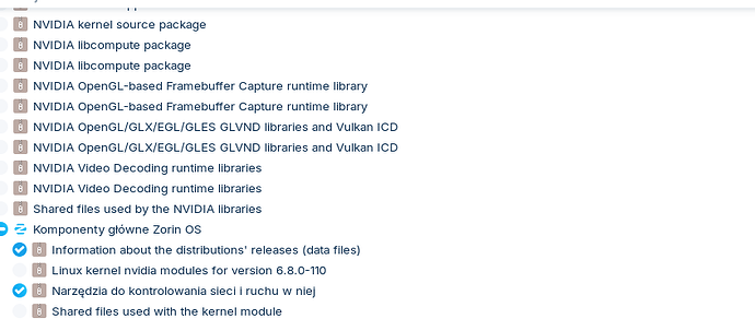

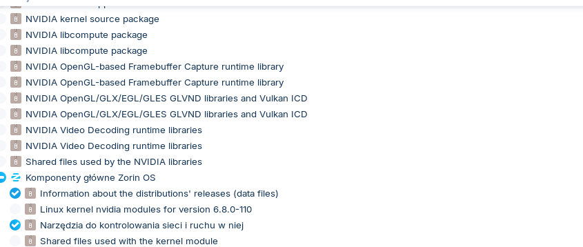

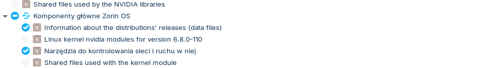

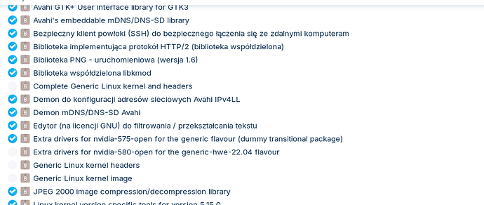

My softer updater don't want update kerner components and nvidia drives
Hello :smiley:
I return
after rest and waiting about situation with ubuntu servers, and...still my software updater don't want update linux header and nvidia drives - can I force it?
I update at the moment this was checkced(without kernel modules etc)
Do you use a VPN? It can cause problems to download the updates. So test if it helps to turn it off for the updates.
No, I don't use VPN - I can update all checked packet - Without kernel module and nvidia rdives

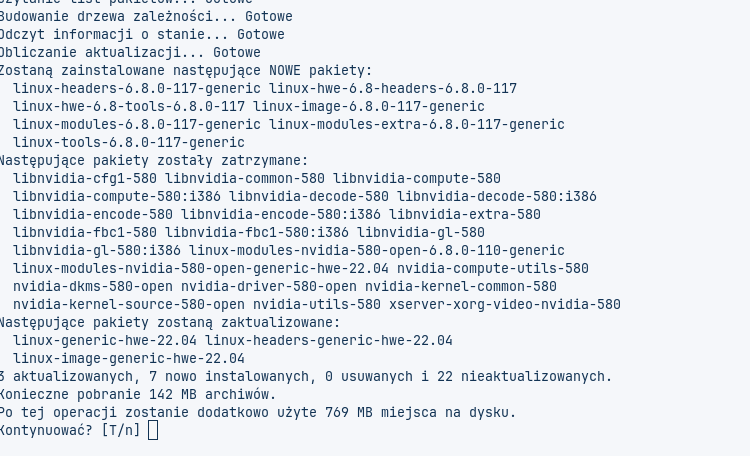

Do you get errors when you run
Is there shown, that the packages are hold back or so and not updated? If possible, please translate the terminal output of the errors into English.
than llinux-generic-hwe-22.04 linux-headers-generic-hwe-22.04
linux-image-generic-hwe-22.04 will be update, linux-headers-6.8.0-117-generic linux-hwe-6.8-headers-6.8.0-117
linux-hwe-6.8-tools-6.8.0-117 linux-image-6.8.0-117-generic
linux-modules-6.8.0-117-generic linux-modules-extra-6.8.0-117-generic
linux-tools-6.8.0-117-generic will bi installed and other packed(nvidia) was stopped
Ok I update kernel:
is this ok?
sorry, I can't read the output. I see no errors there and would wait until the update is available. Sometimes there are phased updates.
it menas than these packet will to upgrade?
Yes, but some days later. I'm not sure what is with your nvidia packages because I can't read the output.
Could You post here the whole Terminal Output please?

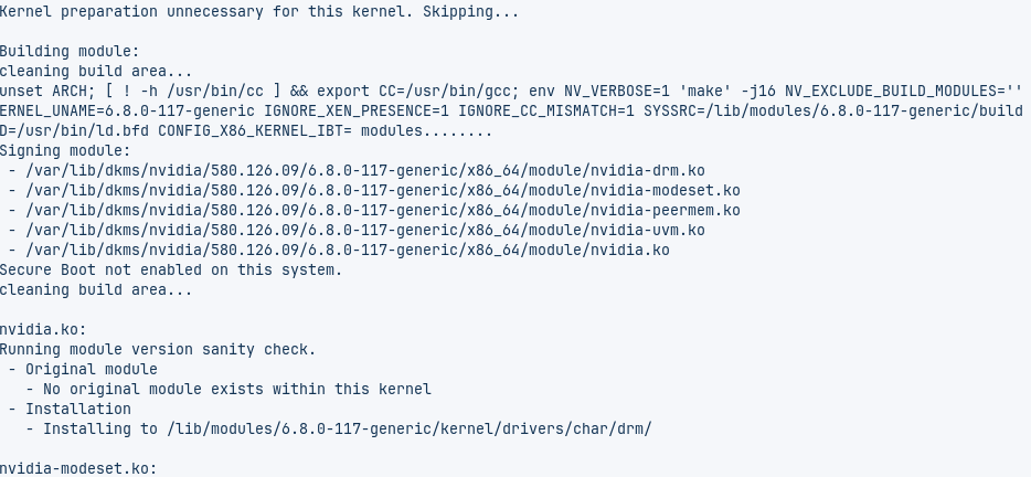

of course :smiley: This is output:

/etc/kernel/header_postinst.d/dkms:
  • dkms: running auto installation service for kernel 6.8.0-117-generic
Kernel preparation unnecessary for this kernel. Skipping...
Building module:
cleaning build area...
unset ARCH; [ ! -h /usr/bin/cc ] && export CC=/usr/bin/gcc; env NV_VERBOSE=1 'make' -j16 NV_EXCLUDE_BUILD_MODULES='' KERNEL_UNAME=6.8.0-117-generic IGNORE_XEN_PRESENCE=1 IGNORE_CC_MISMATCH=1 SYSSRC=/lib/modules/6.8.0-117-generic/build LD=/usr/bin/ld.bfd CONFIG_X86_KERNEL_IBT= modules........
Signing module:
  • /var/lib/dkms/nvidia/580.126.09/6.8.0-117-generic/x86_64/module/nvidia-drm.ko
  • /var/lib/dkms/nvidia/580.126.09/6.8.0-117-generic/x86_64/module/nvidia-modeset.ko
  • /var/lib/dkms/nvidia/580.126.09/6.8.0-117-generic/x86_64/module/nvidia-peermem.ko
  • /var/lib/dkms/nvidia/580.126.09/6.8.0-117-generic/x86_64/module/nvidia-uvm.ko
  • /var/lib/dkms/nvidia/580.126.09/6.8.0-117-generic/x86_64/module/nvidia.ko
    Secure Boot not enabled on this system.

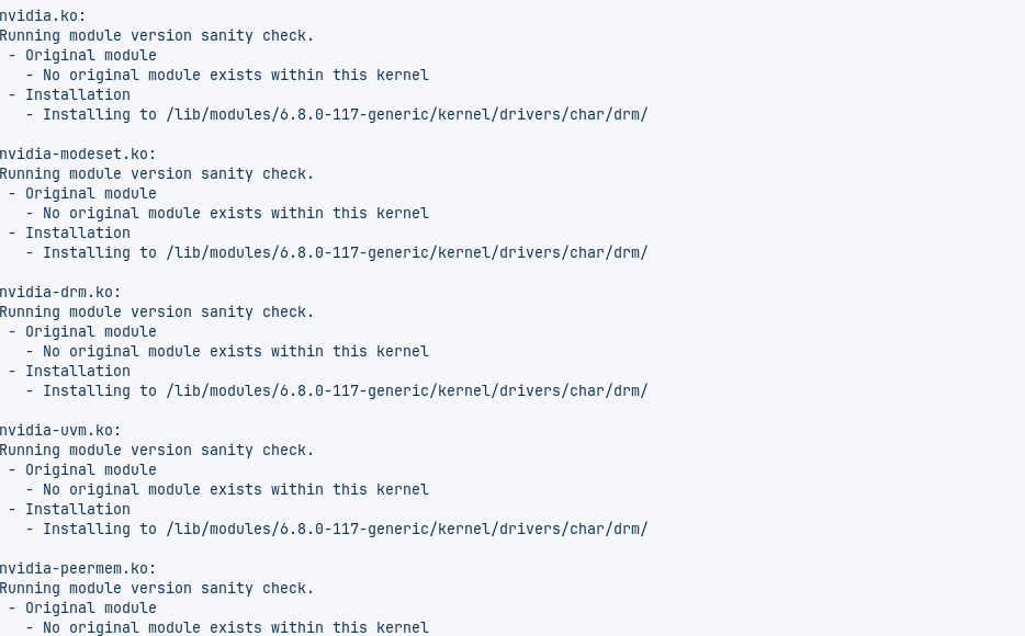

nvidia.ko:
Running module version sanity check.
  • Original module
    • No original module exists within this kernel
  • Installation
    • Installing to /lib/modules/6.8.0-117-generic/kernel/drivers/char/drm/
nvidia-modeset.ko:
  • Original module
  • Installation
nvidia-drm.ko:
  • Original module
  • Installation
nvidia-uvm.ko:
  • Original module
  • Installation
nvidia-peermem.ko:
  • Original module
  • Installation
depmod...
...done.
