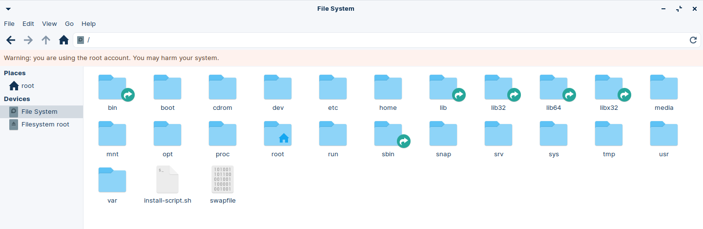

Two days ago I installed python 3.11 and PIP3, but PIP3 was not working and was showing me a series of errors which led me to search for solutions in forums, one of them was to remove "dist-packages" from some "Python" folders inside /bin and /lib using Thunar in SU mode.
Shortly after I got errors when using the Package Manager and immediately I got a "Software Updater" error in the taskbar and since then it does not open that program:

Regarding what I deleted, I deleted the "python3.8" folder from /lib (or /bin, I don't remember) AND the dist-packages folder from the "python" named folders I found.
