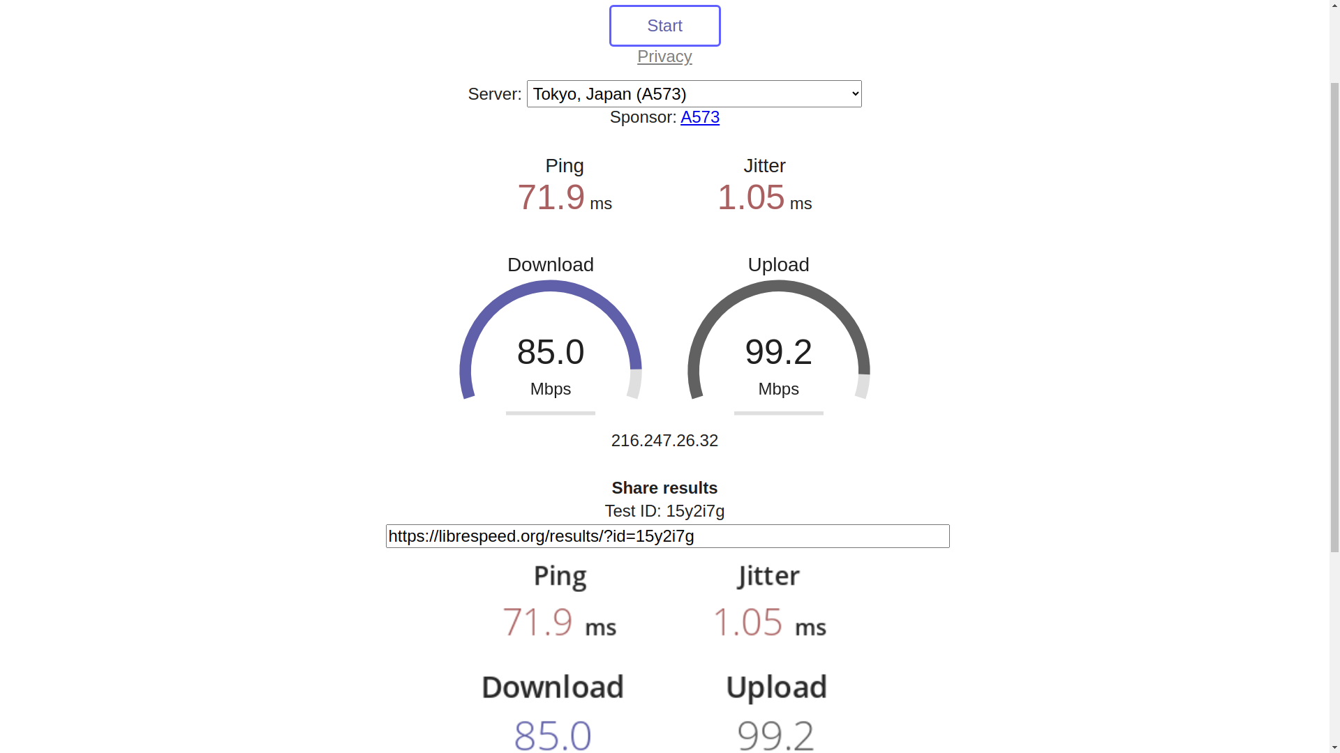

Need a command or apt for finding out what programs are running in the background .... it seems my upload speed is faster than my download speed .... I'm using LibreSpeed - Speed Test and this is according to it's findings ..... in the past all my uploads have been much slower than my downloads ....

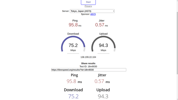

I am using ProtonVPN but it doesn't matter if I have it turned it on or off .....
This is with VPN turned on ..... my ISP plan calls for 100 Mbps ....

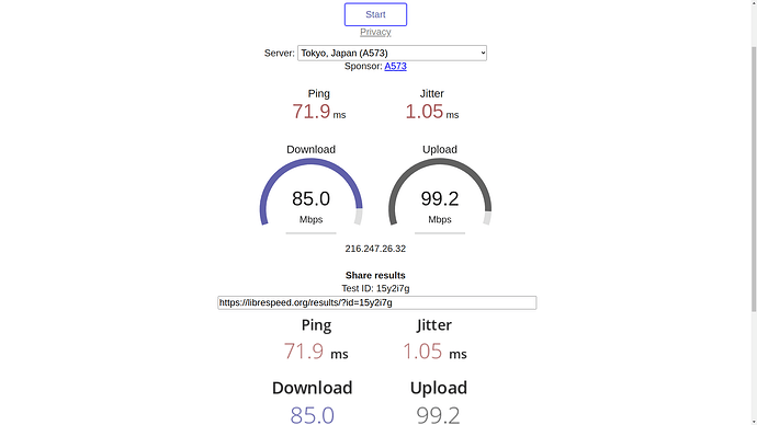

And this is off .....
When you have your VPN off, it seems like you're getting pretty close to your advertised speeds (85 to 100 is pretty close). As annoying as it is, when ISPs advertise speeds, it's always "up to" , so that when you inevitably don't get exactly that number they have a buffer. You could also try another server to speed test to, and even another speed test application, as they vary significantly.

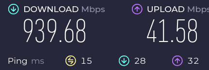

FYI, those of you who have gigabit speeds, are so lucky! It literally took 2-decades, till my cable provider, finally provided me speeds worthy of 4K. This is the best I can achieve for supposed 500MB internet.
A lot of network straining happening around here as you call it, everybody shares off the same main cable line off the power poles, and they split it off to each house. Coax cable will always be behind FIOS fiber optics. And since the provider owns a monopoly, they prevent fiber optics from being installed in my area, so I am stuck.
