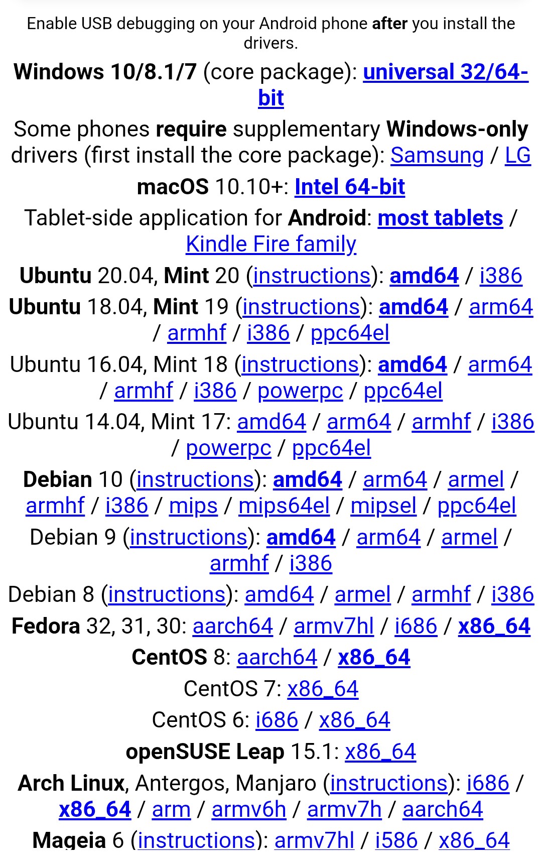

Hello, I downloaded zorin os 18 core. I put it onto a USB to try it out and see how well it functions. For my pc, I need easytether for internet, usb to phone. According to easytether website, it should work straight out of the box. The os recognizes my phone, and I can access it just fine. However the os is not recognizing easytether. So, I downloaded the drivers install file.deb, and tried to install it. It would not install. I opened terminal and got it to install that way, however it left the program unconfigured as it requires libssl1.1 to function properly. Researching how to download and install libssl1.1 I found that it has been discontinued and replaced with libssl3. Can someone please tell me if there is a zorin os repository that may have libssl1.1 in it that I can download and install? I contacted easytether about updating their drivers, but am not hopeful. I am very new to Linux and am trying hard to learn as much as possible, but this is a bit confusing.

Easy tether is no more maintained for linux and only available for ubuntu 20.04 and older. Zorin doesn't offer a version wich is still supported with updates and based on ubuntu 20.04. For Zorin 18 you need .deb files for ubuntu 24.04.
Hi, I know. That is why I came here asking if there is a way to add libssl1.1 back in so I can use easytether, or if anyone knows of a workaround. The only info I could find on the internet about adding 1.1 back in, said it may mess things up, so that's why I signed up here and asked.
