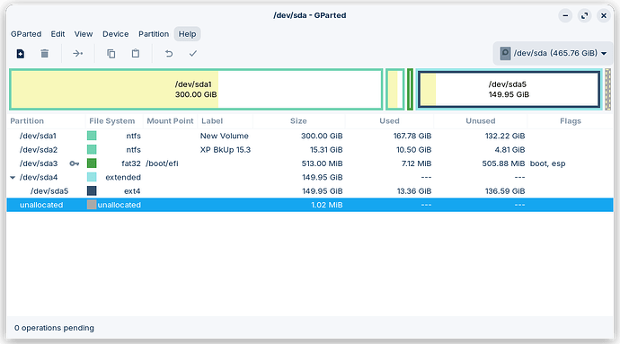

And could You install in Zorin GParted? You can install it with the Terminal Command sudo apt install gparted and then start it. Don't wonder, you have to type in Your Password when it starts. that is normal. And then please make a Screenshot of Your Partitions and post it here.

Partition map follows:
It is unusual that you do not have a boot partition at the beginning of the hard disk. This can cause the problem that you can't start Windows because the bootloader is not found.

Another Thing: Install GParted with sudo apt install gparted and post a Picture of Your Partitions here.
