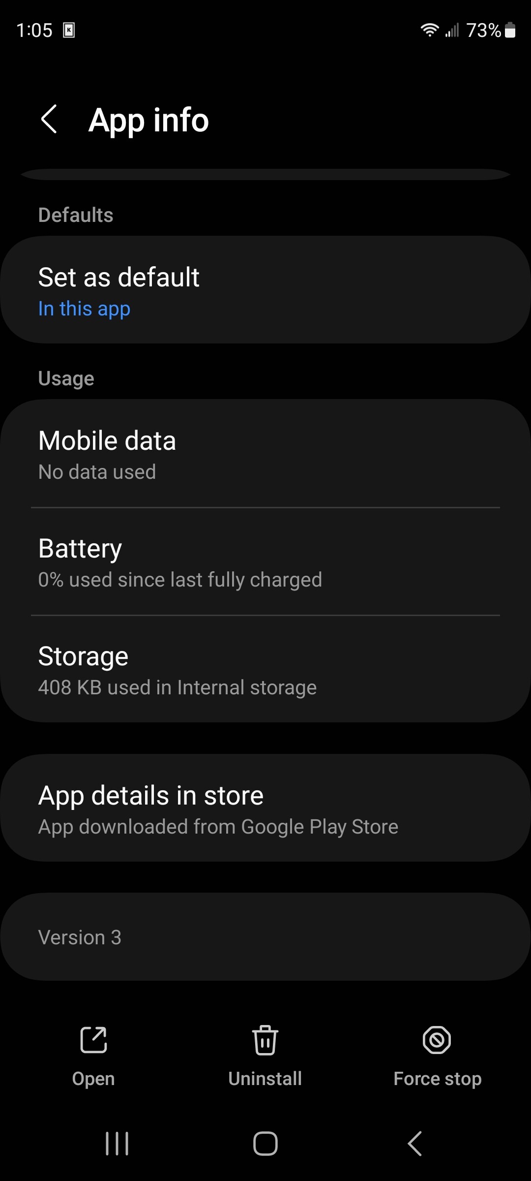

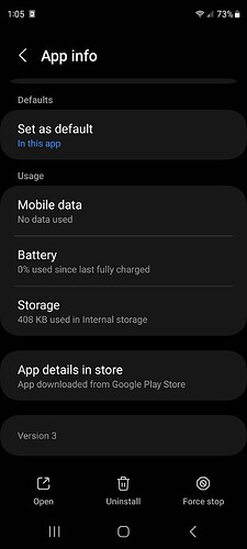

If I look at app details,.it says it was installed from Google Play Store.

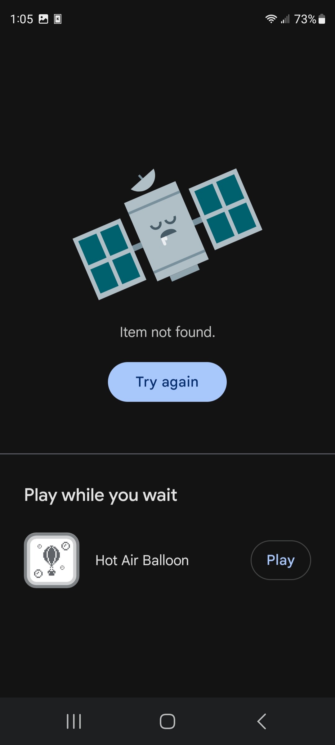

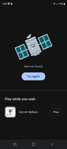

But if I follow that link...
Aww, looks like the satellite lost its orbit, and floated into a black hole.
Episode 2 GIF by Star Wars
I agree Yoda, it most indeed is, I suspect Google of unnecessary tampering.
A quick update:
The ZorinGroup has confirmed that they have never published a Forum App to the Play Store.
However, on Android, many browser versions will prompt the user on creating a PWA in a way that will make you think you installed the webpage as an app - I think it is more likely that this is what happened to you and me.
Checking the app details; it is consistent with a PWA as it is very small.
But it is possible that a third party can wrap a PWA and put it out on the web; If it is not official, I would carefully check and possibly remove anything claiming to be a Zorin Product that is actually not.
