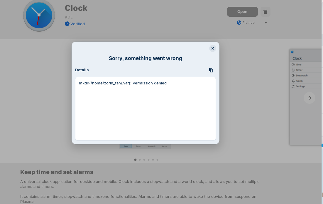

After installing one of the clock apps listed in the start menu of Core 18, clock app won't open & I get the following message:
It says permission denied and it shows you installed it as a Flatpak.
Flatpak packages are isolated from the system so they lack permissions to access what they need.

For your installed flatpak package it can help to install "flatseal", then open it and select your clock app and at category filesystem grant access to all users/system files.

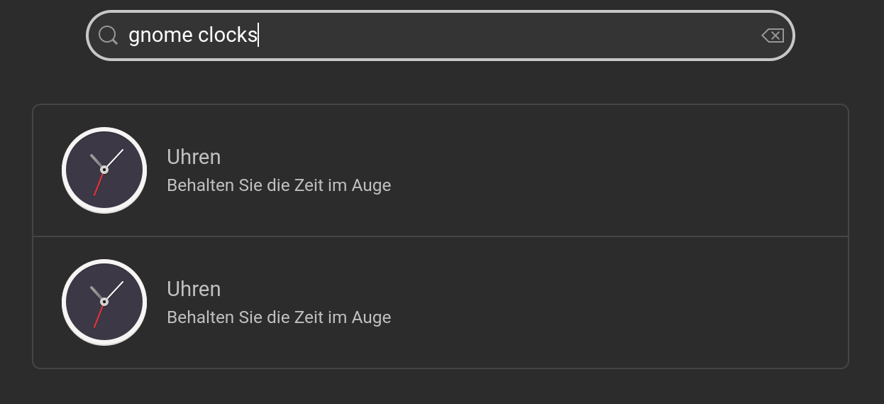

When You type in ''gnome clocks'' it should look like this:
(ignore the german Language please)
So, You have 2 Entries. One is the Flatpak and one is the .deb Version.
