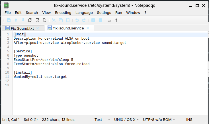

I even tried this following suggestion I found on the forum:
"Automate the ALSA Reload Script
If the issue persists, create a systemd service to automate the fix:
  1. Create the service file: sudo nano /etc/systemd/system/fix-sound.service
  2. Add the configuration to force-reload ALSA, with a 5-second delay to allow services to load.
  3. Save, exit, and enable it: sudo systemctl daemon-reload and sudo systemctl enable fix-sound.service."
    this is the result:
    That hasnt help to create a fix.

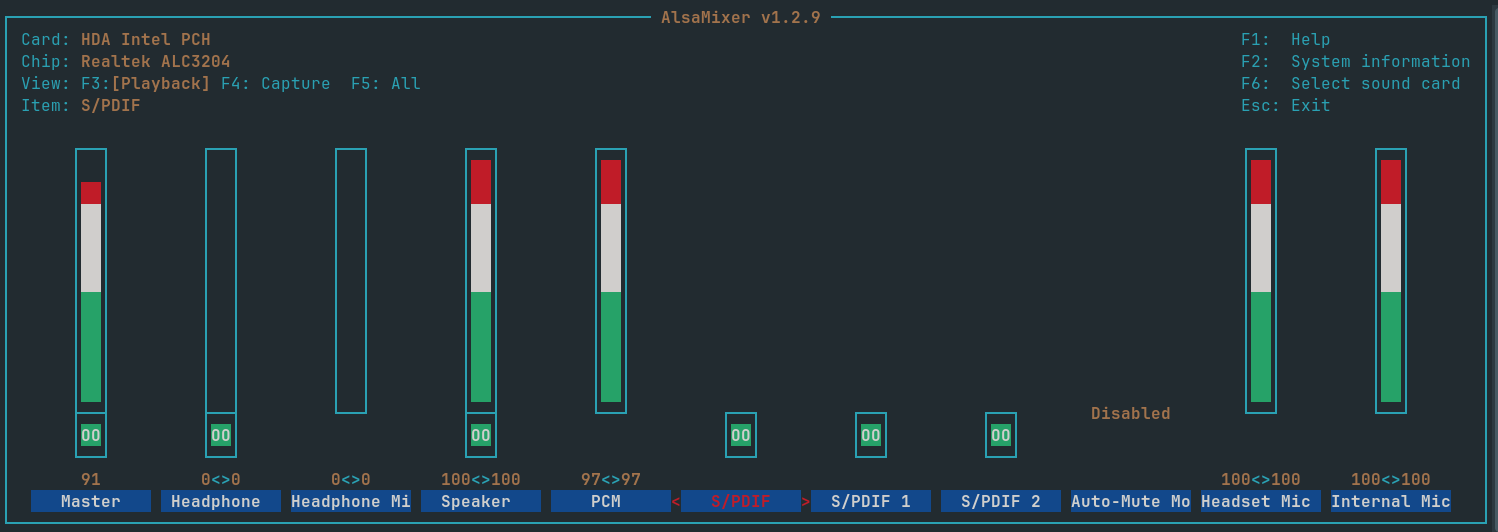

output after running alsamixer in terminal:
Any advise is appreciated.
