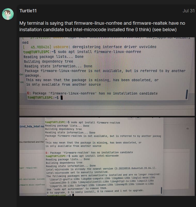

Then it will be good idea back some settings if not working when you tried something . I reading when you tried installing Realtek in linux the firmware don't have a candidate. Your screens upper.
What's that supposed to mean?
That could be means.
Well, both drivers in that link have the letters "rc" in them, which to me means release candidate, which means alpha or beta, which means unfinished and buggy.

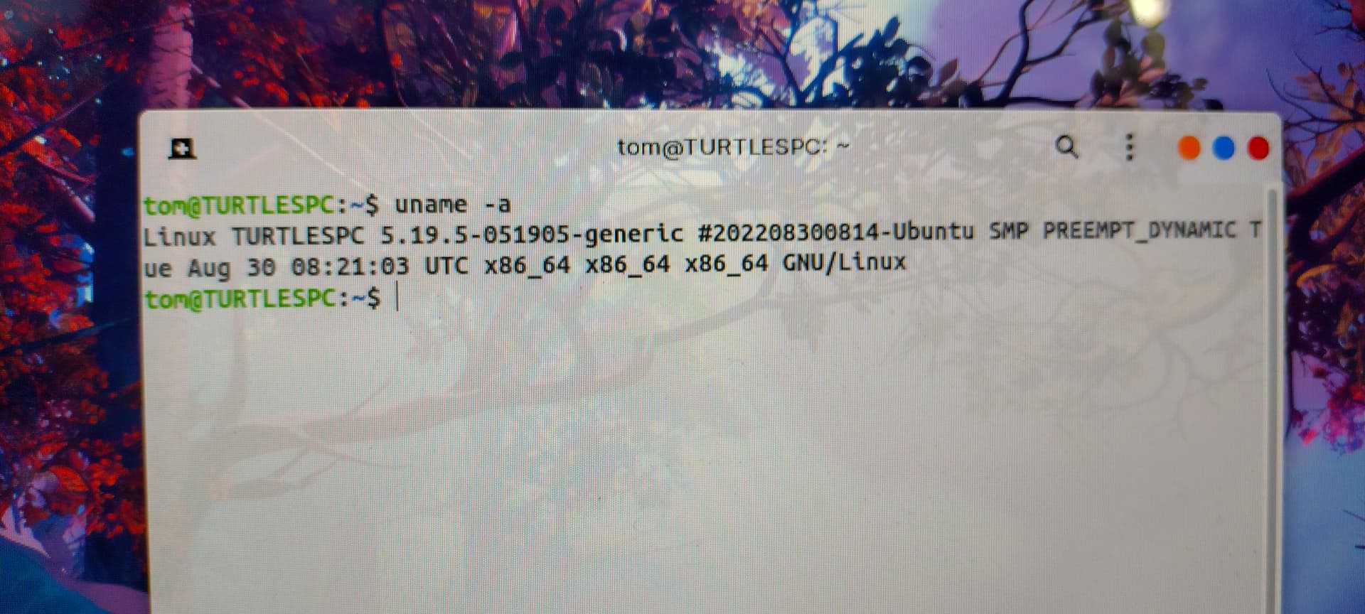

In terminal run
uname -a
to ensure you are using the 5.19 kernel, then check your sound devices...

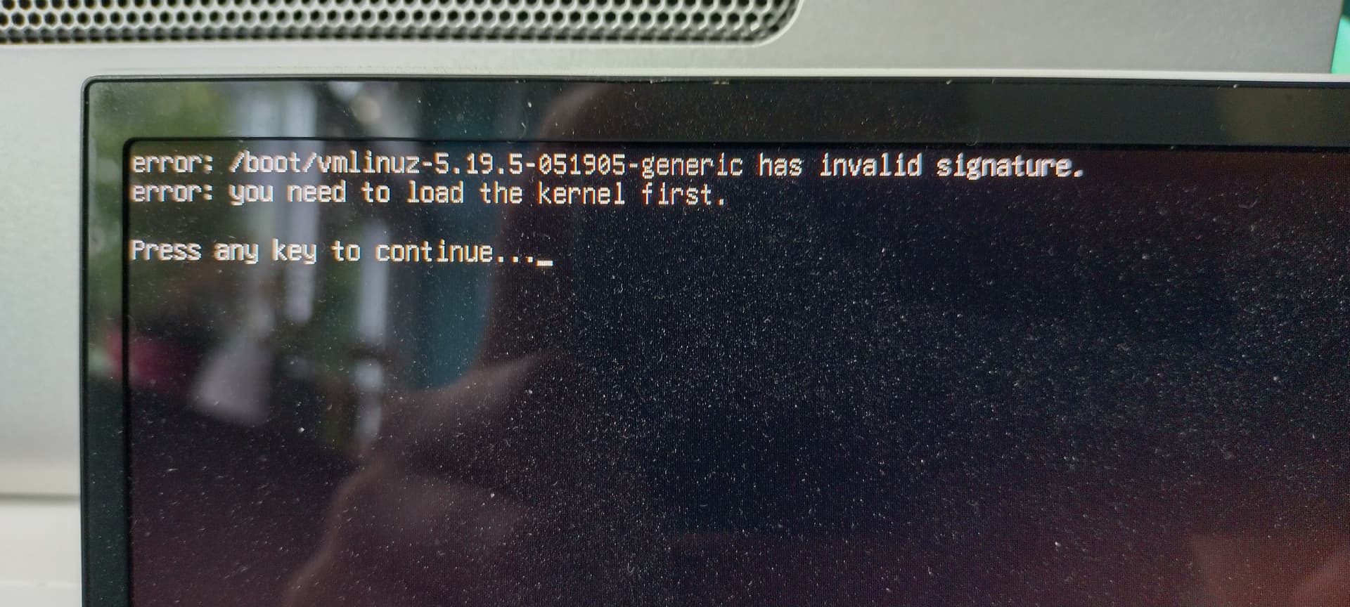

Invalid signature...
It's a good thing you taught me how to downgrade...
I'm not sure there is a lot more we can do...
It appears that you have Secure Boot enabled in your BIOS /EFI settings...

Disabled secure boot...
...and installed kernel 5.19...
...but still the same error.
Now we may be out of ideas...

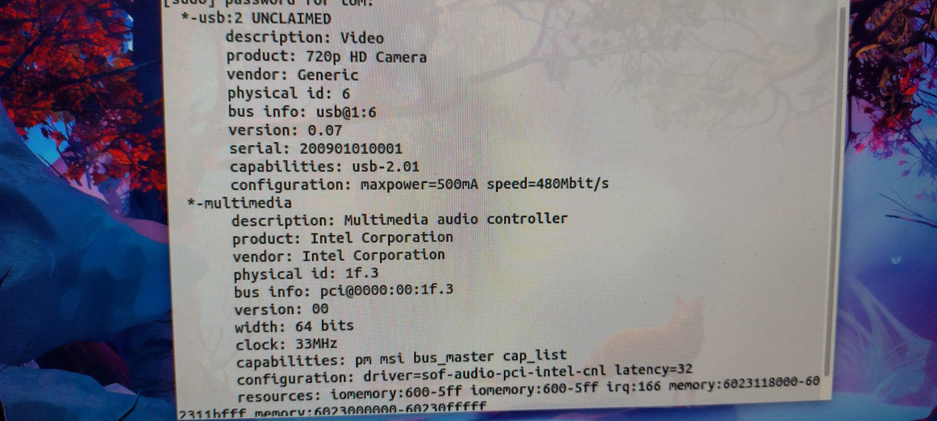

Can you please post the terminal output of
sudo lshw -C multimedia
I'm pretty sure I switched from pulseaudio to... what was it called again? Pipewire?
Hmmm sof-audio-pci-intel-cnl...
Let's try falling back to the intel driver and not using SOF.
