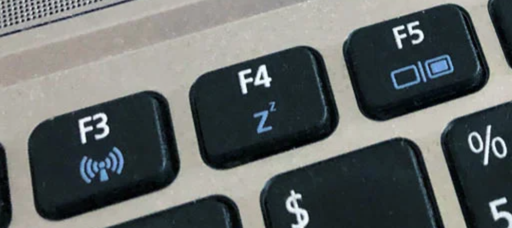

Please check your ACER Aspire 15 laptop if there is a switch or WLAN key, here the foto shows F3 with blue WLAN sign. In this case you can press key Fn together with key F3 to turn WLAN ON - OFF. But your hardware might have other keys or a switch for WLAN. Hope this could help you!

Using the WLAN key (F3) makes no difference.

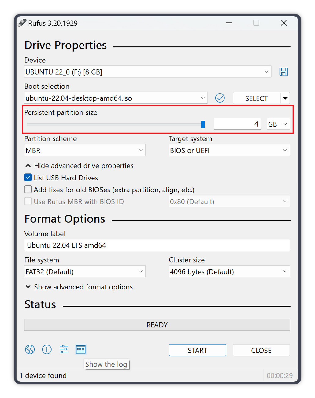

There would be an Alternative to Ventoy when this doesn't work this Way: When You have a Windows Machine, You could use Rufus. With that, You can create A USB Stick with Persistence, too. And it is directly in the Program:
