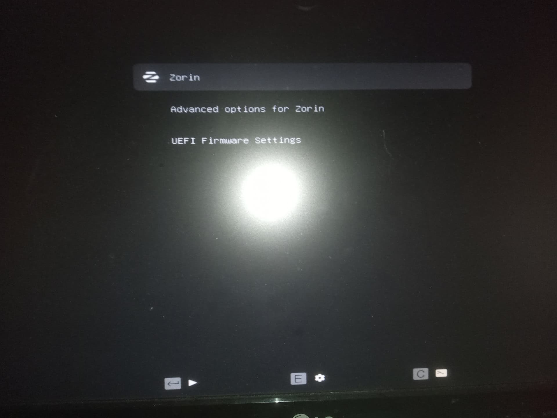

To get into BIOS you need to hammer the appropriate F key like a mad woodpecker from the start, before you get to this screen.
If you can get into this, you can just go into Firmware Settings. From there, some computers offer a temporary override boot sequence option. So you can just select your USB drive and boot from there directly one time.
This may be a daft question? but with the USB plugged in I get this, can I do anything from here? have tried many times it is F12, but to no avail.

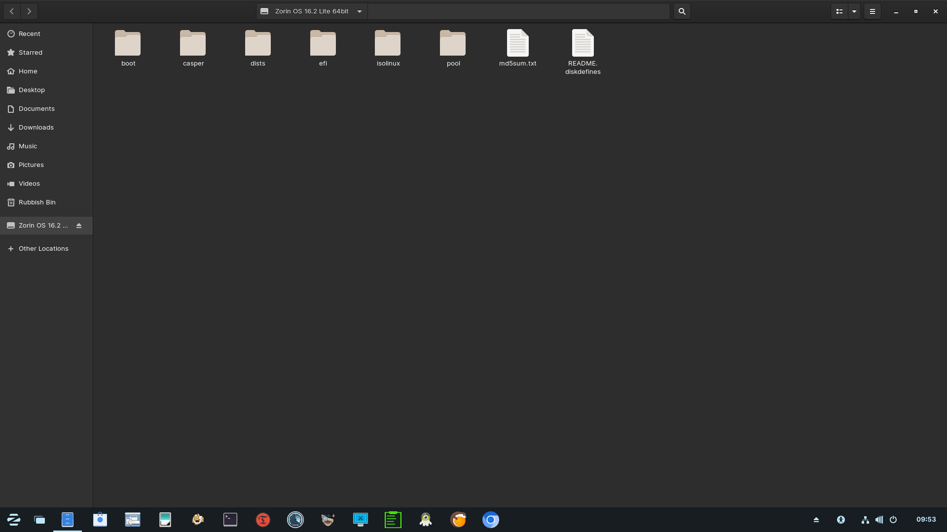

Could this be the problem?
Screenshot_2023-07-14_10-49-09
I cant get into that, there are just a few windows files in there, I still can not get into boot options.
Let's check if your Zorin is using MBR (Legacy) or EFI boot.
