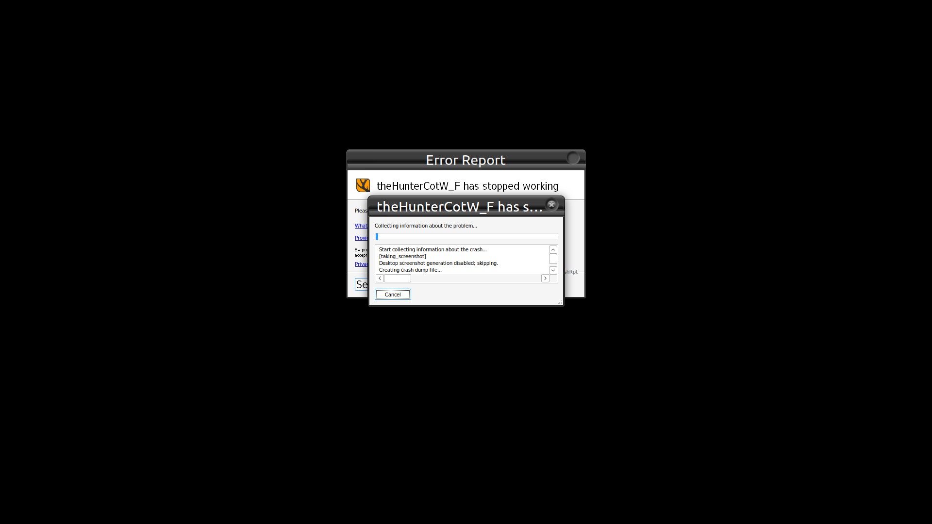

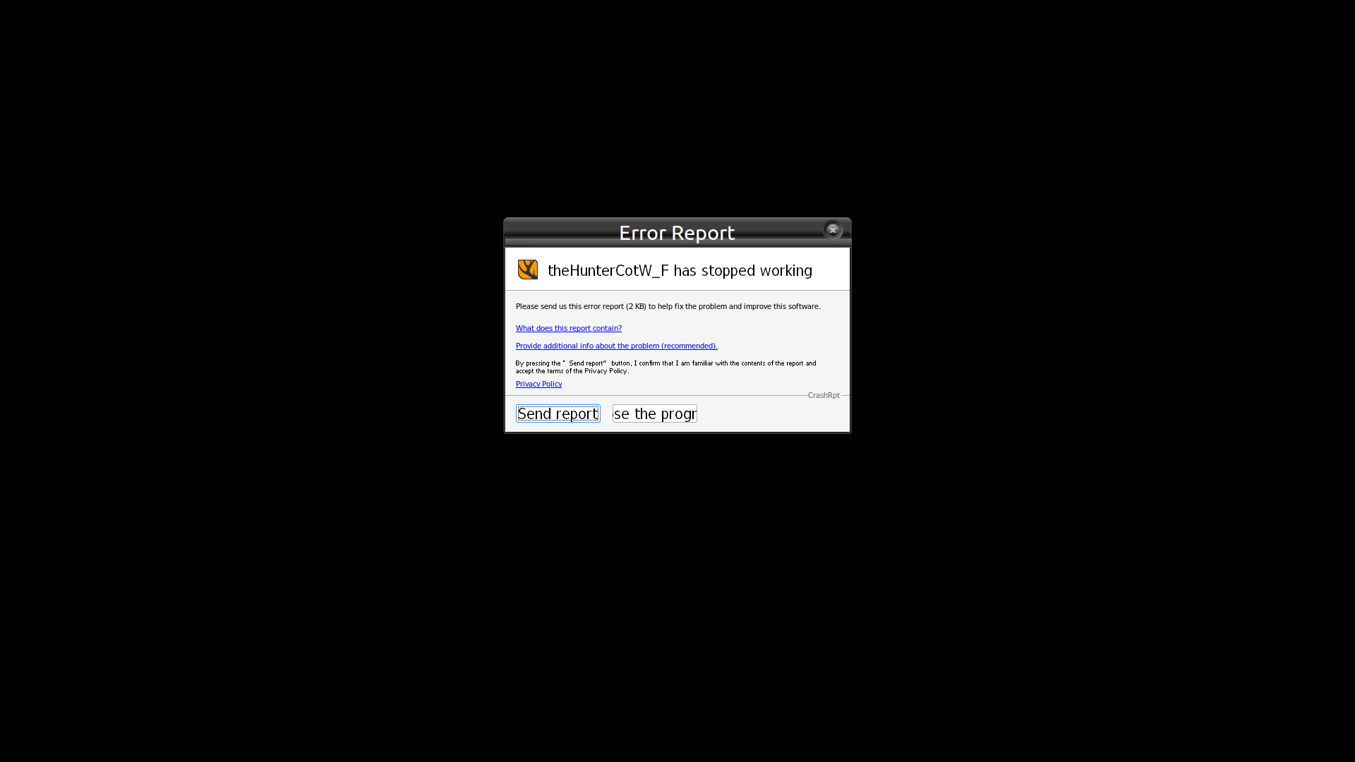

Tried both .... was on Proton Experimental but tried Hotfix still no change ..... at one point it did try to start the game but then it closed and I got the following messages ..... they were blinking on and off so fast I was lucky to get a photo of each one ... took many tries ....
