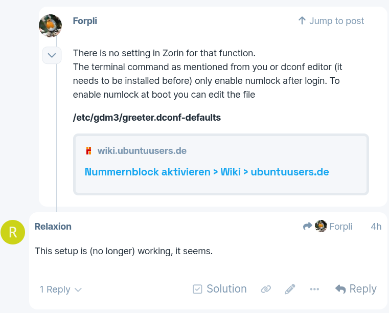

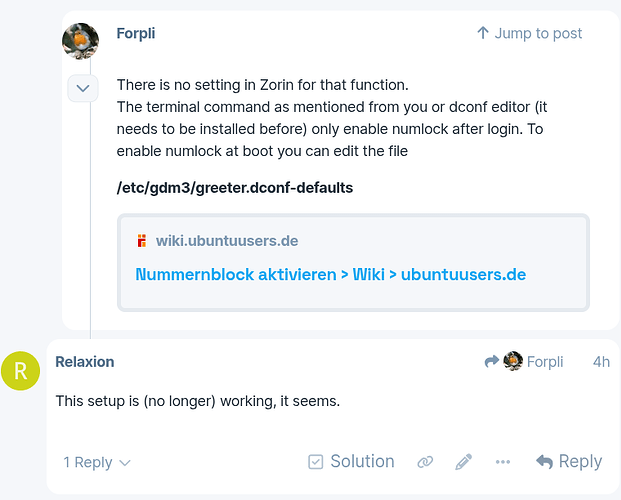

There is no setting in Zorin for that function.
The terminal command as mentioned from you or dconf editor (it needs to be installed before) only enable numlock after login. To enable numlock at boot you can edit the file
/etc/gdm3/greeter.dconf-defaults

This setup is (no longer) working, it seems.
