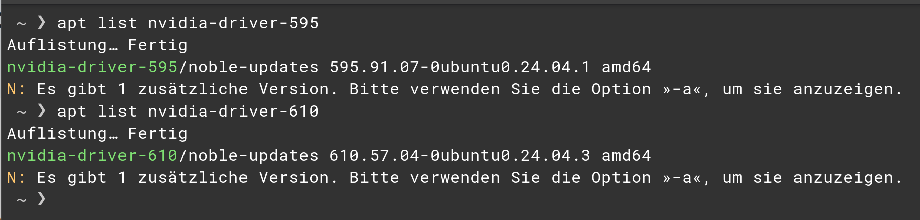

That is actually not true. In the Repos is the 595 Driver available. There is even the 610 Driver:
So, you should be able to use this Command:
directly to install the Driver. Alternatively, take a _Look at the ''Additional Drivers'' Tab in Software & Updates.
Could You also say what Nvidia Card You have? I ask because when it is a 10XX Card, You can't go higher than 580 because the Support for these Card in the higher Drivers was cutted.
