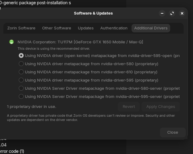

Hello, did an update a bit ago (which seemed to take unusually long), afterwards, my NVIDIA drivers seem to be broken. There was a return error....
dpkg: error processing package linux-modules-nvidia-590-generic-hwe-24.04
it listed a couple things but it's not showing now after attempting to switch to the X.org driver (which seemed to work ok), then switching back to the NVIDIA driver (595). After switching to the X.org driver, I performed another update/upgrade via terminal, then switched back again, this time attempting the '580' driver but same result. Aside from the performance improvements for gaming, I'm not able to use all 3 of my displays as only 1 is recognized with the broken driver.
Thanks in advance.

try into app
I've already tired the (open kernel) and the (proprietary)....
Same result for both
