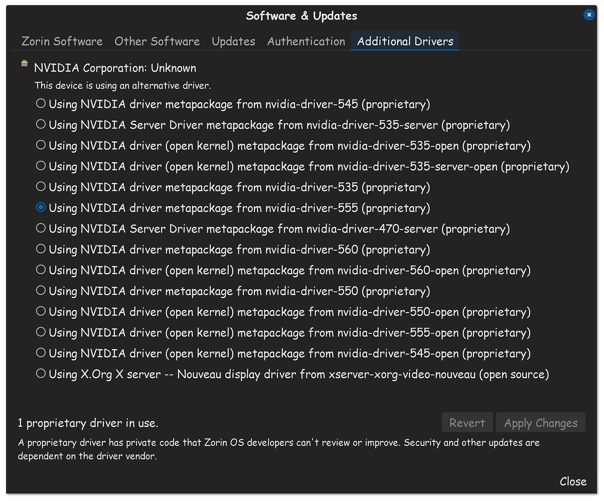

I take StarTrekers screenshot to ask:
Where is the button that does the same as sudo apt remove --purge '^nvidia-.*'?
Do you mean "revert"?
Uh...
I amend my statement to, they are the same action if the GUI has that option. ![]()
