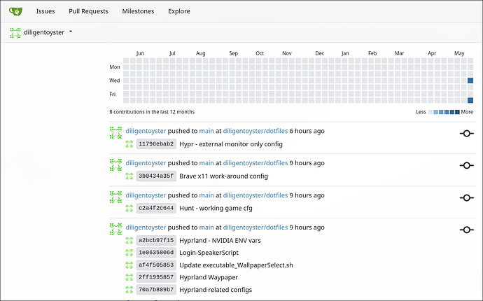

Update: Really good set-and-forget work-around
(!! The following may break or confuse your windowrules in Hyprland. If not running Hyprland, you should be fine.)
Using Brave browser as a example
create the file:
~/.config/brave-flags.conf
and put the following content into it:
--enable-features=UseOzonePlatform
--ozone-platform=x11
The config file above supplies the flags to the Brave browser without requiring typing into the command prompt every time:
Brave --ozone-platform=X11
:+1:

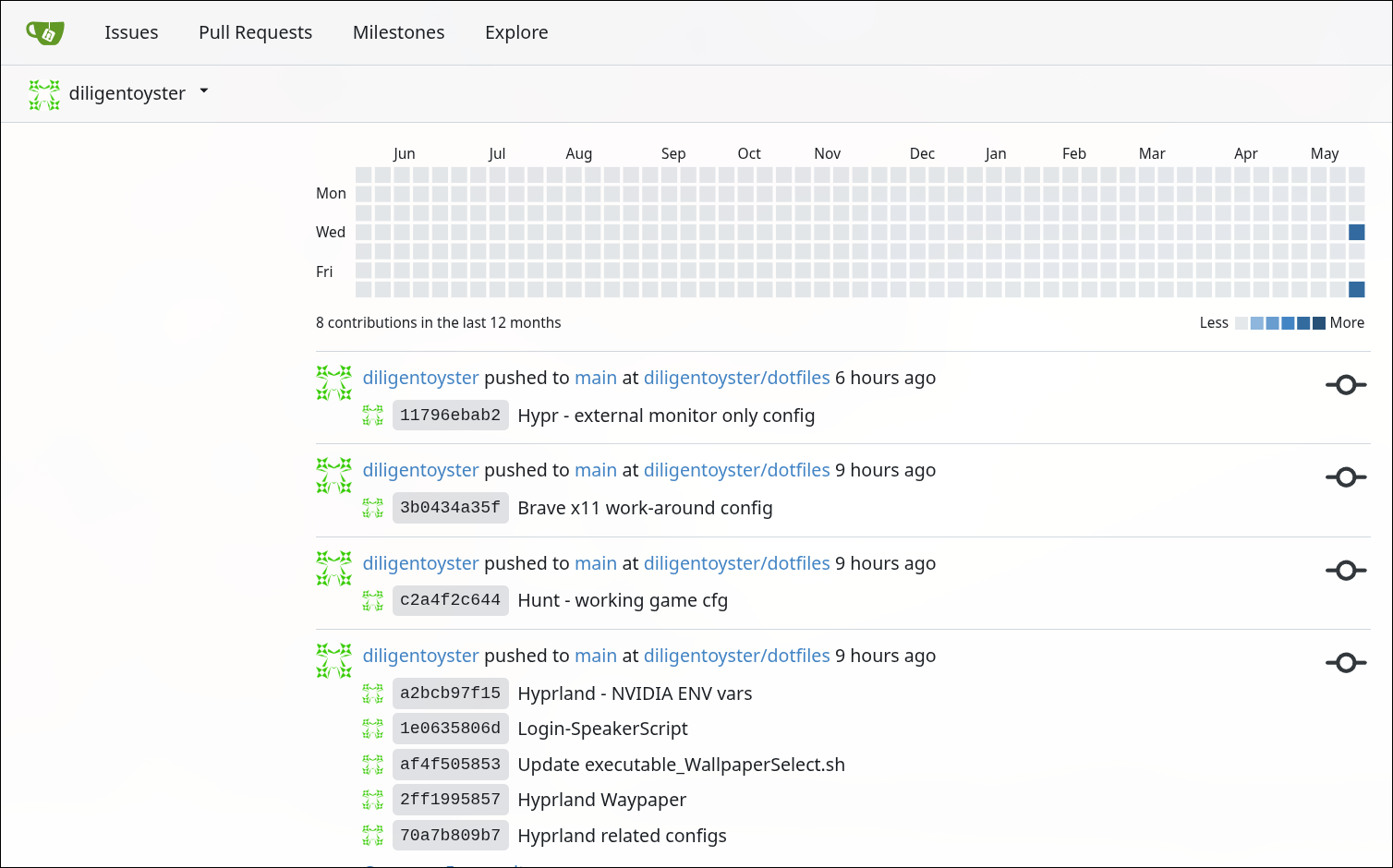

I'm logging bugs and issues within Gitea, so if I break something, I can review the commit history and revert.

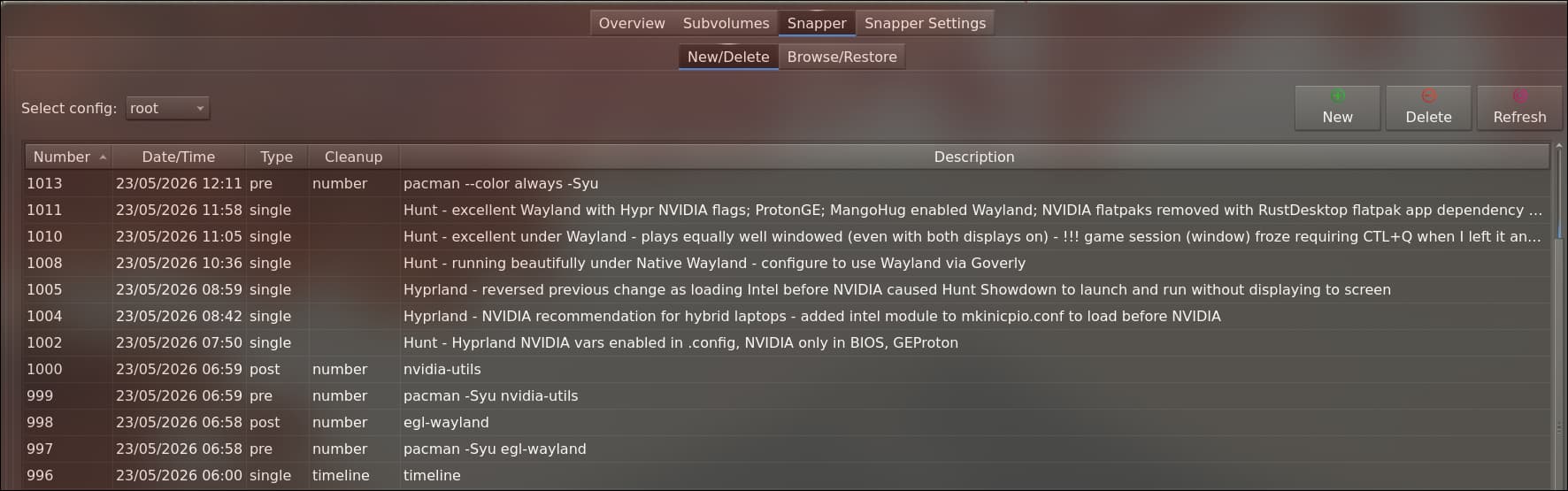

Screenshot of Gitea and BTRFS (Snapshots) Assistant
A couple screenshots of my snapshot and configuration management strategies.
Everything is hosted on my home network using Docker and Proxmox.

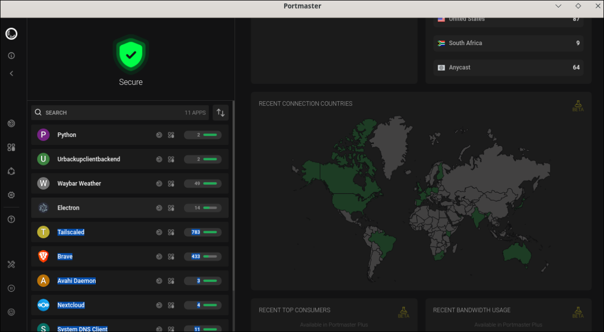

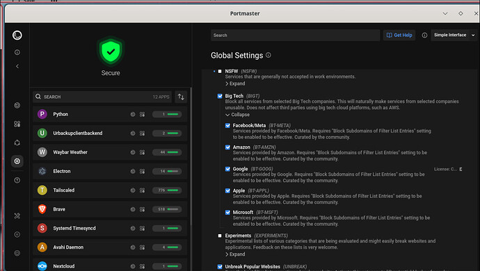

I've been using Safing I/O's Portmaster to locally filter traffic on my main laptop. It's really good for cutting off BigTech traffic in real time.
Have a look.
Warning: It can be quite daunting. Lots of dials and knobs.
Portmaster by Safing I/O
Safing IO Portmaster - Resist Network Surveillance

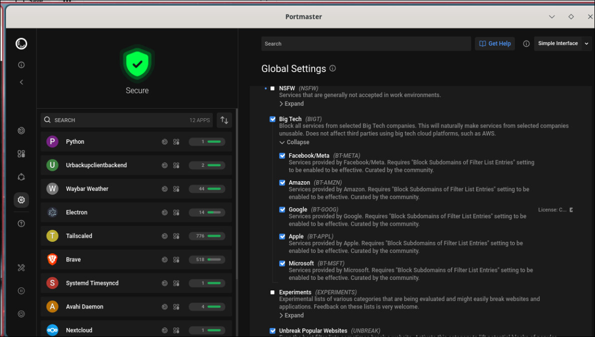

Filter out BigTech
Filter out connectivity to BigTech in real time by simply checking a box within Portmaster to allow/disallow traffic.
I keep the Portmaster UI running in a window off to the side of my browser when I'm having a tinfoil hat day. :grinning_face_with_smiling_eyes:

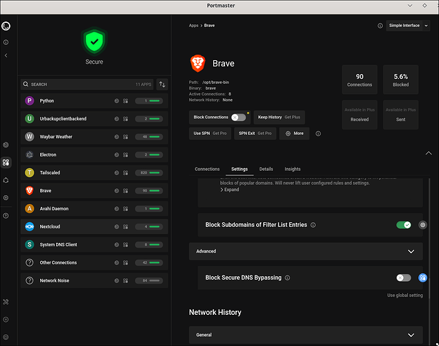

Monitor and filter traffic by source/destination country
Prevent DNS Bypassing by apps
Prevent apps and browsers from bypassing Portmaster DNS monitoring/filtering - configured globally or by browser
Set rules globally or by application
For example, allow Brave browser to use its own Secure DNS settings, whilst blocking other DNS bypassing apps globally.
The power of this filtering is that you can block all BigTech globally, then only enable connectivity as needed per app such as when browsing a BigTech associated website (e.g., YouTube) for a short time.
Once finished, disable connectivity as needed.

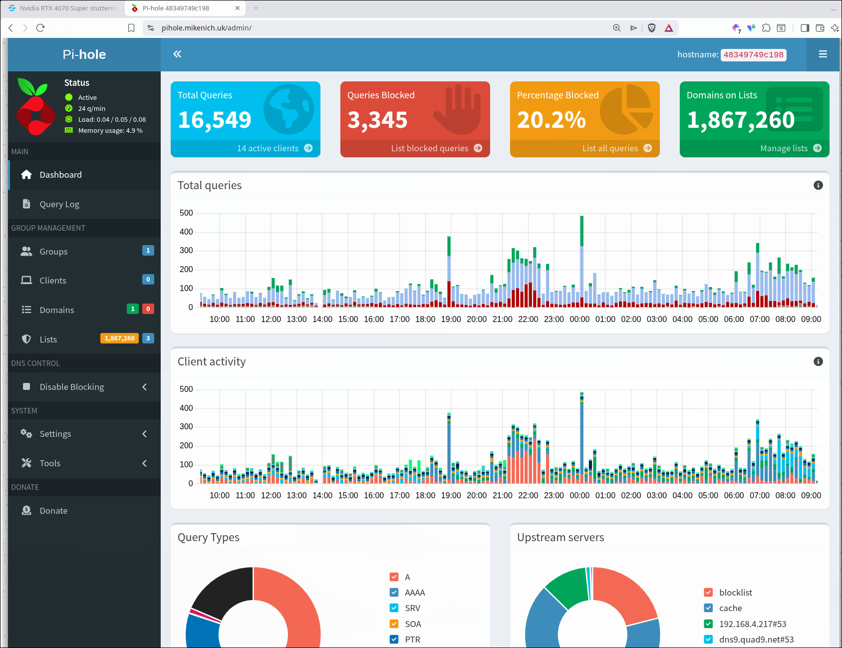

Home Network: Pihole with Unbound
I've also implemented Pihole with Unbound on my home network which in effect filters traffic through Pihole's DNS blocking, then upstreams requests via Unbound. Unbound acts as a TLS encryption gateway and local cache for DNS upstream requests to my trusted, privacy-oriented, third-party DNS provider.
This keeps DNS Lookups from all devices hidden from my ISP. :+1:
