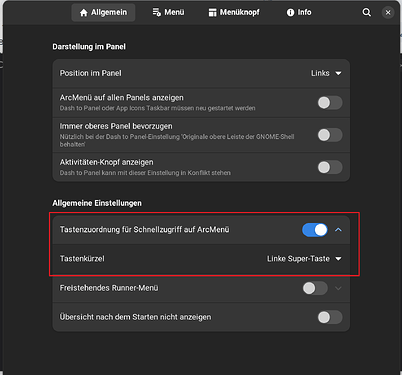

You have to disable the Zorin Menu in Extension Manager. Then only the ArcMenu Symbol is in the Taskbar. And when the Zorin Menu is disabled, the Key should working. I don't use that to open ArcMenu but I tested it. Whe I active this Toggle:
I can open ArcMenu with the Super Key.

@Ponce-De-Leon By disabling Zorin menu in extension manager super key opens Arc menu, so it works now.

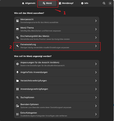

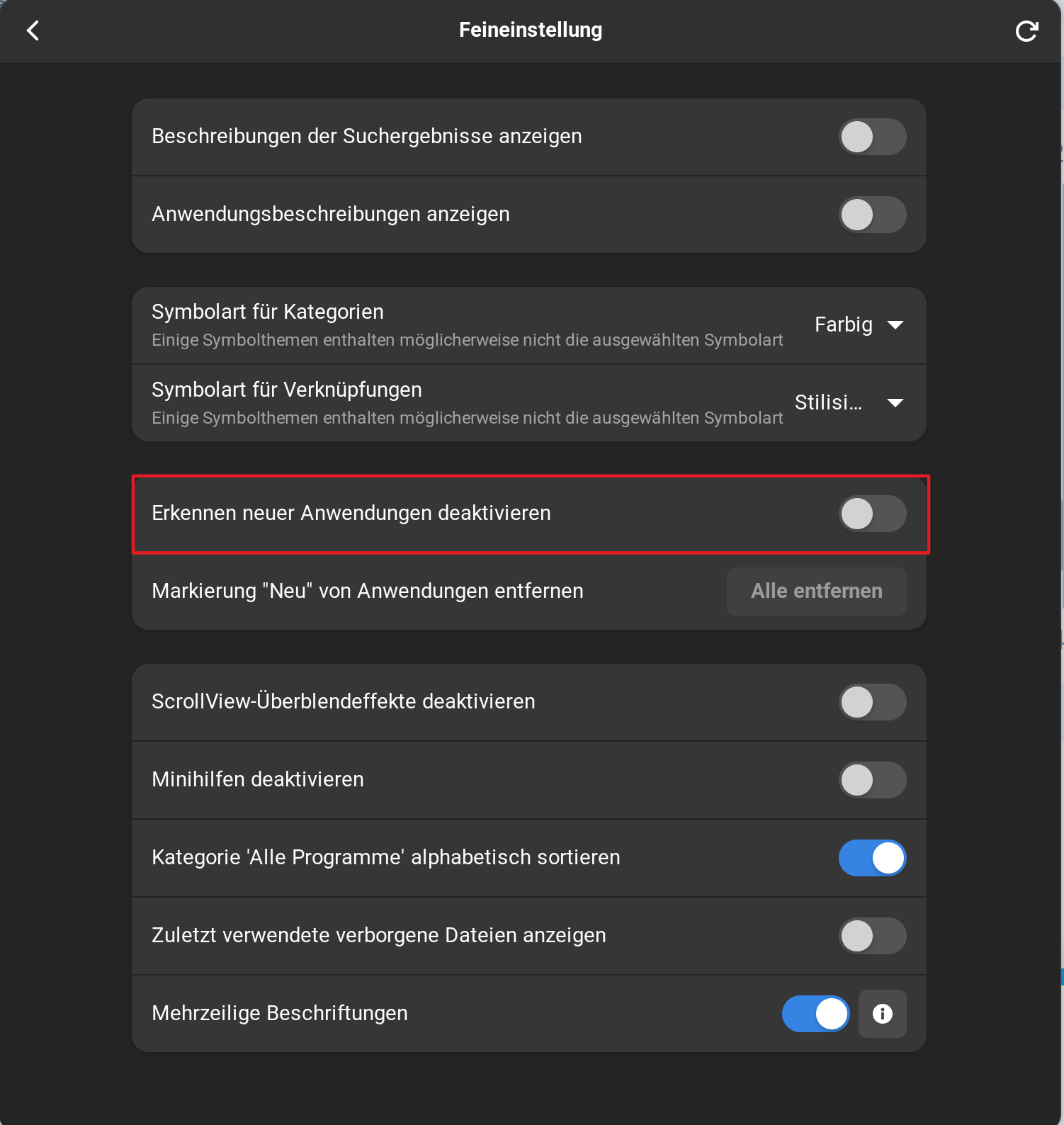

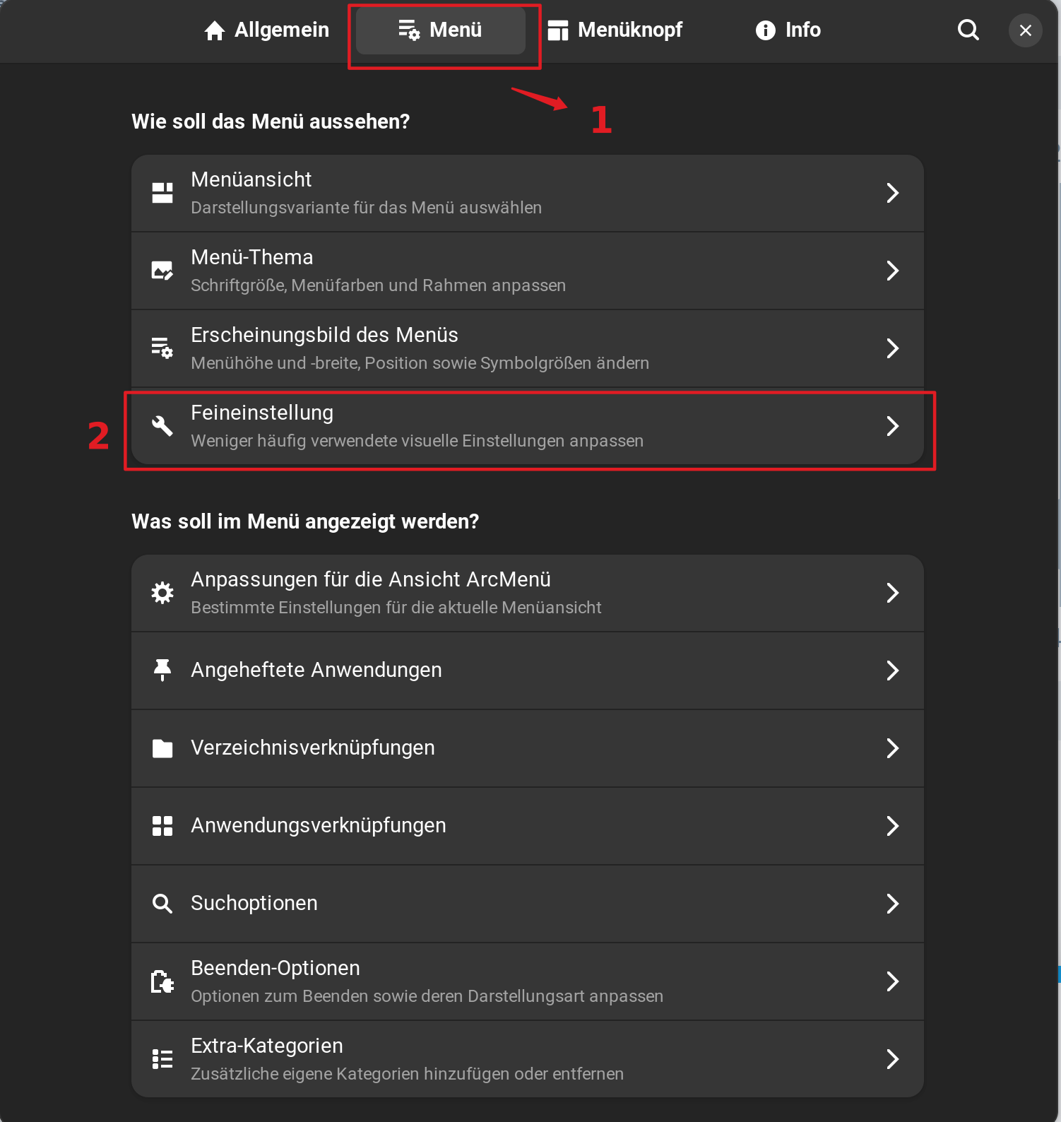

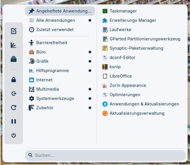

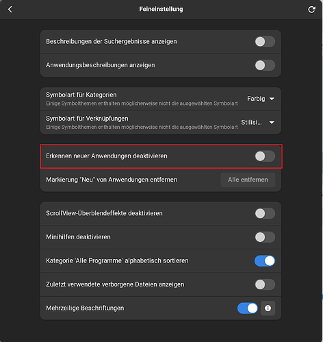

Can the dots :black_circle: behind the rubrics in arc menu (Layout: Mint) be removed? I don't like them.
Yes, You can in the ArcMenu Settings.
Thank you very much, Ponce-De-Leon!
I searched for a reason, why they are not shown everywhere, but didn't find the setting. Now the dots are gone, great!!!
