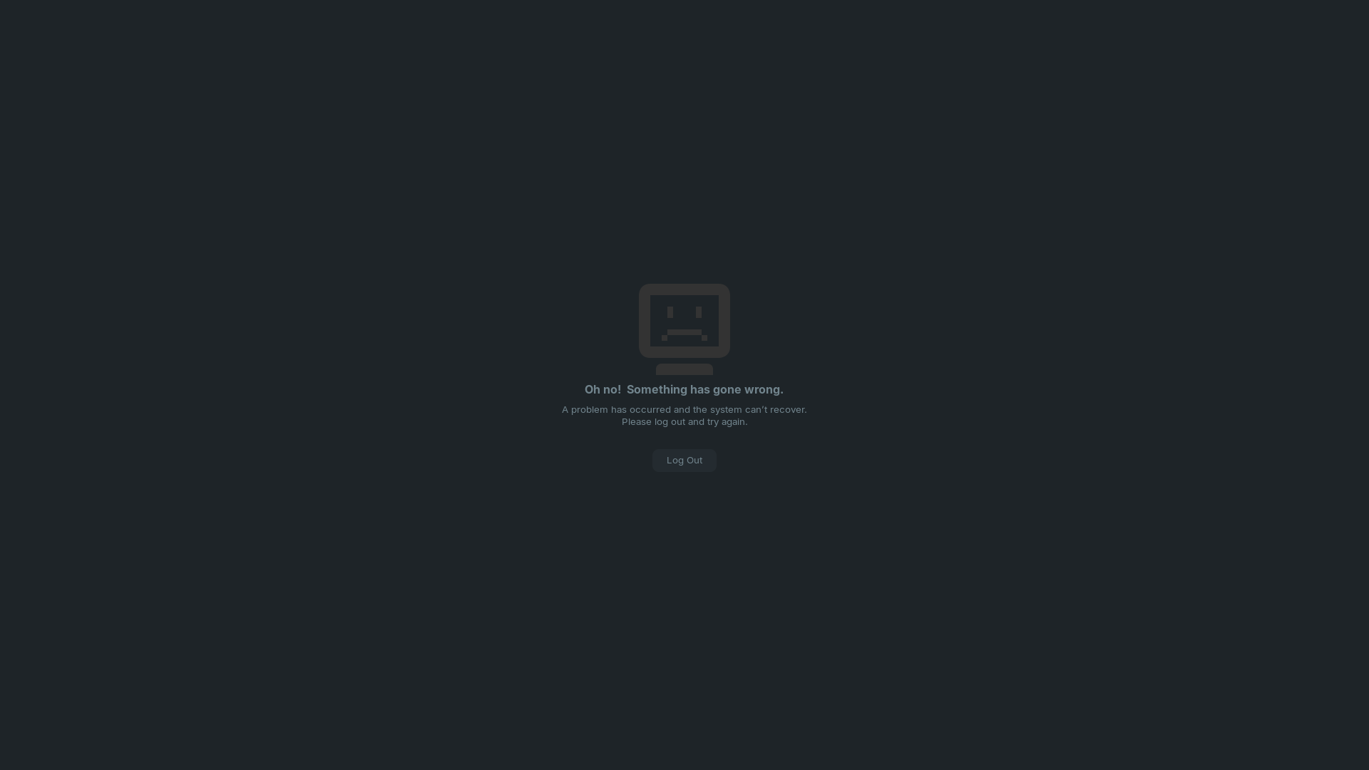

Opening Joplin crashes desktop
This issue happened today, while yesterday I was able to run Joplin just fine (official AppImage from their website). The only thing that comes to mind, I performed a sudo apt autoremove and that ended up removing a lot of packages, but I didn't think much of it since it's only supposed to remove unused ones, right?

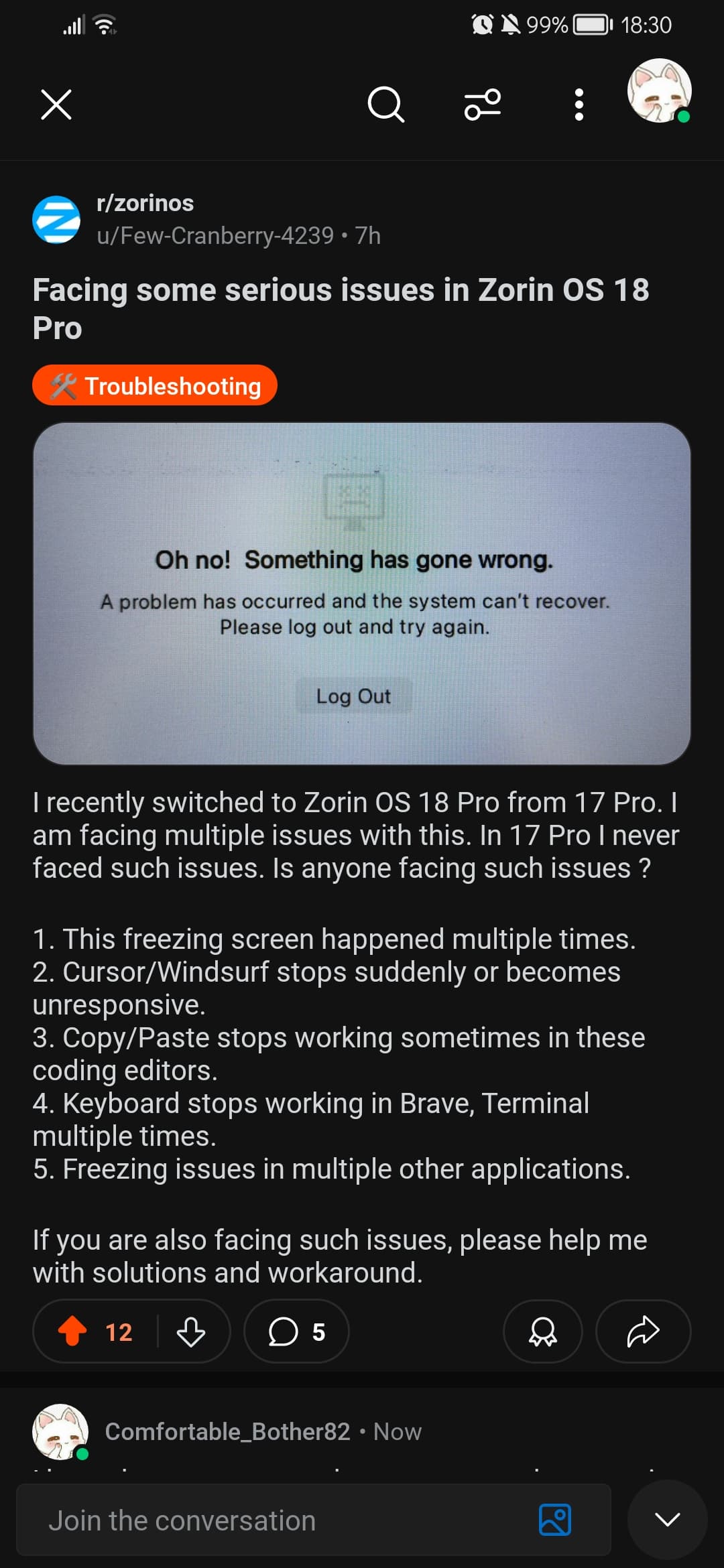

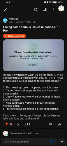

A user on Reddit reported issues with their desktop crashing and giving them the same screen as mine, even if we didn't get it the same way. This seems important enough to relay to the devs.
This issue disappeared for a while, so I just accepted it. I could open Joplin and it wouldn't crash my entire desktop, but it returned again yesterday. Today I realized I didn't try opening it using a Wayland session, and lo and behold, it doesn't crash the desktop when using Zorin on Wayland. Can anyone tell me why it happens so frequently on Xorg and how I can fix it? I really don't want to use Wayland because of a multitude of other very annoying issues.
