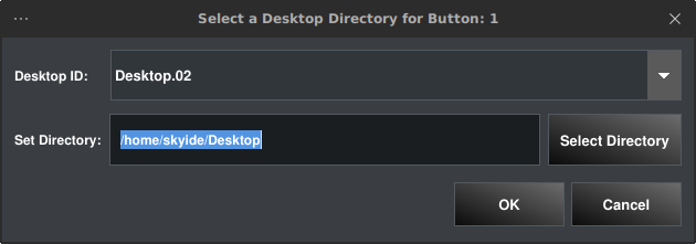

I didn't find out how to enable different backgrounds and icons for each virtual desktop. I read that it should be possible by saving the settings in different files. Would you please explain how to do this?

About different backgrounds and icons for each virtual desktop, you need to right click a Virtual Desktop button and select "Change / Set Directory" (see the screenshot below).
You need to select the correct desktop ID.
The Desktop ID is displayed in the bottom right corner of the desktop watermark but also in the title bar of Control Panel: Right-click the desktop and select Environment and Workspace Settings.
Once the a desktop directory is set, just click a different virtual desktop button and go back to old one and you can start switching between desktop directories.
Right now, you can set a different wallpaper background per monitor but not per virtual desktop. Setting a different wallpaper per virtual desktop will be implemented very soon as it's been on my mind for a while now, it's just that I am not up to it yet.
Ah, I just read the last sentences. I tried everything to get different backgrounds for the virtual desktops, but didn't work. Now it is clear. I only have a laptop and no external monitor, so it is not possible yet.
