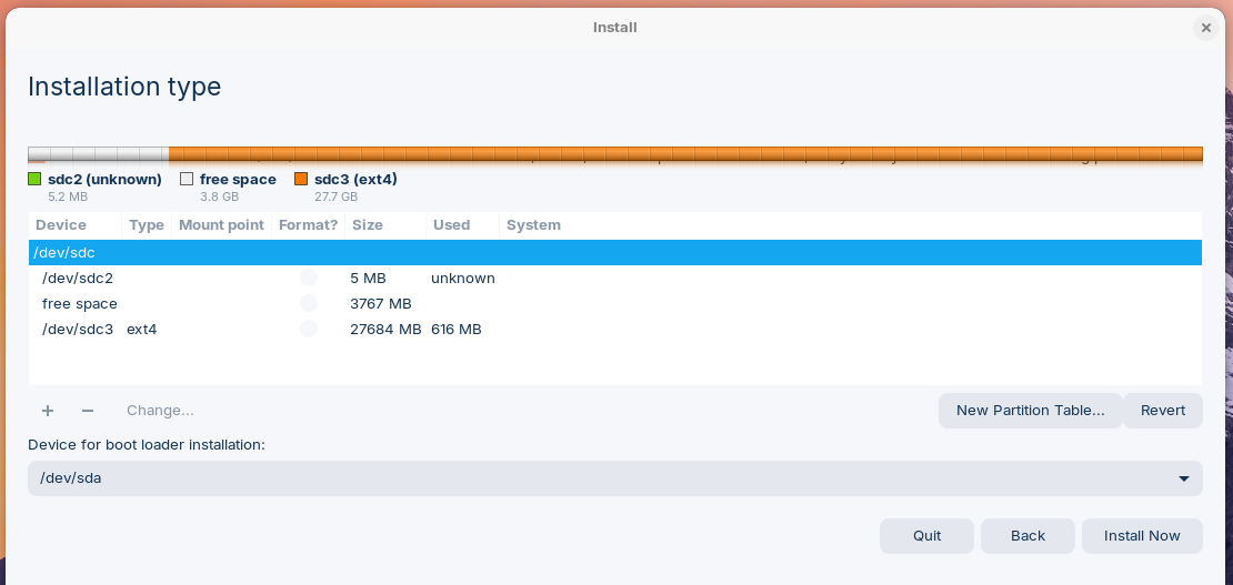

after a successful installation on an old MacBook Pro, I now want to install ZorinOS on a HP Pavillon Ultrabook 15 (Intel Core i5 from 2012) under Windows 10.

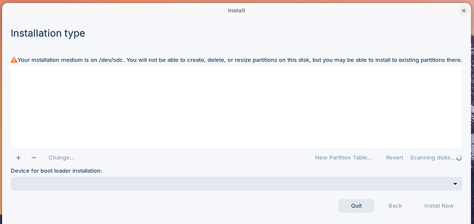

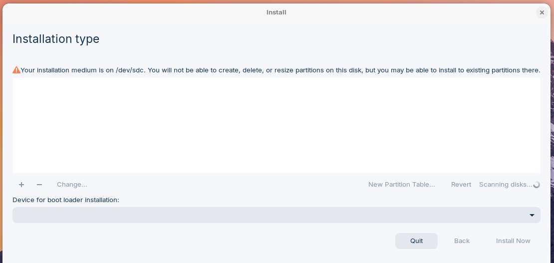

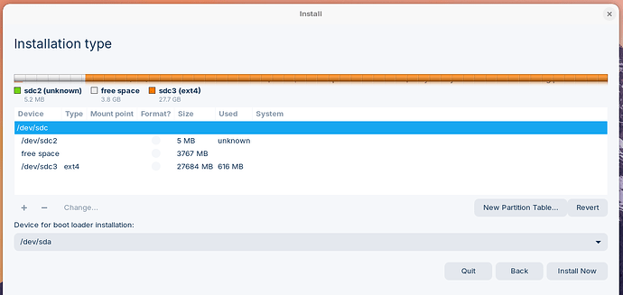

When installing, I do not get an option like "... Something else". Instead, the partition table is showing up with a warning message (see screenshot 1). In the partition table, only the installation USB drive is visible (screenshot 2):
Fast Boot, Fast start in Windows as well as Secure boot are disabled. Bit locker seems not to be active as it is not even shown in the Control panel.
Also a separate partition on the HD is not showing up. Goal is a Dualboot installation (Windows/ZorinOS).

I will delete the F again. As mentioned, I created it due to the missing screen that you are showing below. When I started this topic, I mentioned that this screen with the option "Something else" is not showing up in my case. I only get the two screens you see in my starting post (see here again):
