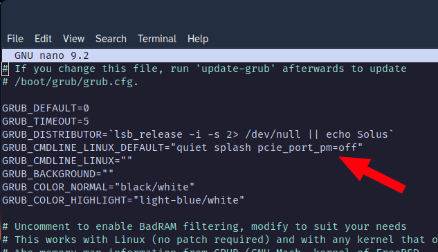

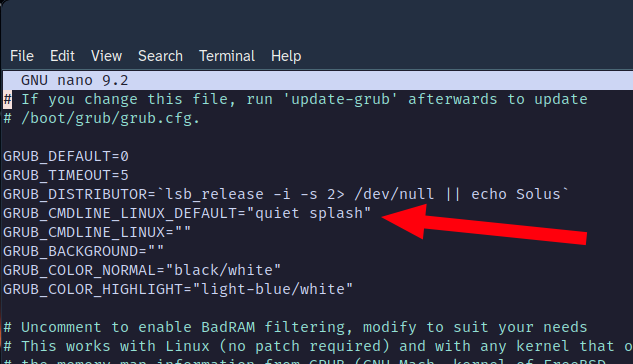

This possible solution is essentially editing a text file that contains grub's (the bootloader) basic configuration settings, and adding instructions to disable PCIe power management that may be putting your wifi card to sleep too aggressively.
In that file, there should be a lin that begins with GRUB_CMDLINE_LINUX_DEFAULT= and contains some keywords in quotations. Here's mine in the nano terminal text editor:
Keep whatever is already inside the quotes and add pcie_port_pm=off before the closing quote, with the leading space to separate it from the existing content. Like so:
After you save the file (Ctrl+S in most visual editors including gedit or Ctrl+X, Y, Enter in nano) you then run sudo update-grub to make it apply the configuration changes so that the new PCIe power management instruction will be in effect the next time you boot into Zorin.
