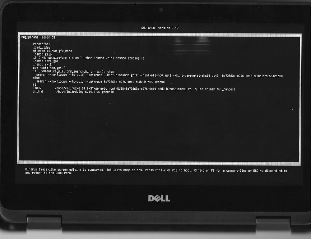

I did the entire installation and it seemed to go well but after rebooting the shut off issue is still present. This is the GRUB screen I get when I press ESC during boot:
Rotated your image, whilst keeping the original. Zab
