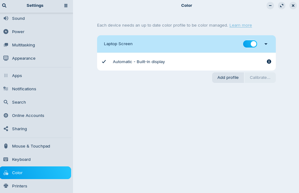

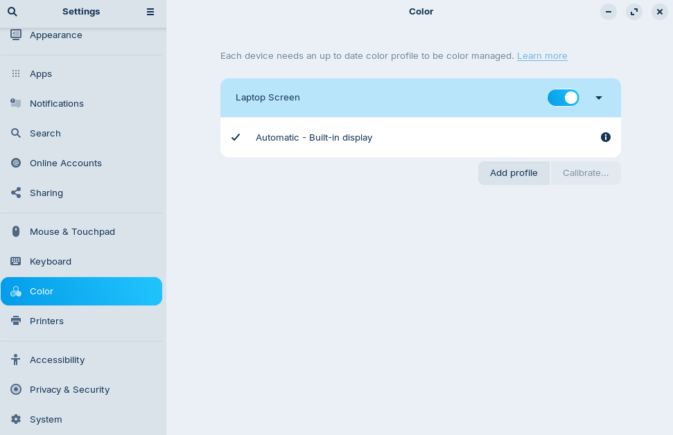

I'm currently logged in and using 'Zorin Desktop' while writing this not 'Zorin Desktop on Wayland' and Pinch out to Zoom in as well as Pinch in to Zoom out does not work, I installed Touchégg but it just uses the browser zoom shortcut, rather than zooming in the area where my mouse is, however when switching to use 'Zorin Desktop on Wayland' then logging in, Pinch out to Zoom in/Pinch in to Zoom out does infact work, as it does zoom in to where my mouse cursor is, but I want that to work on 'Zorin Desktop' as I have the correct Color Profile on 'Zorin Desktop' not 'Zorin Desktop on Wayland', on 'Zorin Desktop on Wayland' it causes images to lose it's vibrancy which I prefer and need. What 'Zorin Desktop on Wayland' has, it lacks the Color Profile that I had on 'Zorin Desktop' but has the correct Zoom Gestures that I was lacking on 'Zorin Desktop' and what 'Zorin Desktop' has, it lacks the correct Zoom Gestures that I had on 'Zorin Desktop on Wayland' but it has the Color Profile that I prefer and need, how do I have the same Color Profile and same Zoom Gestures on both 'Zorin Desktop' and 'Zorin Desktop on Wayland?

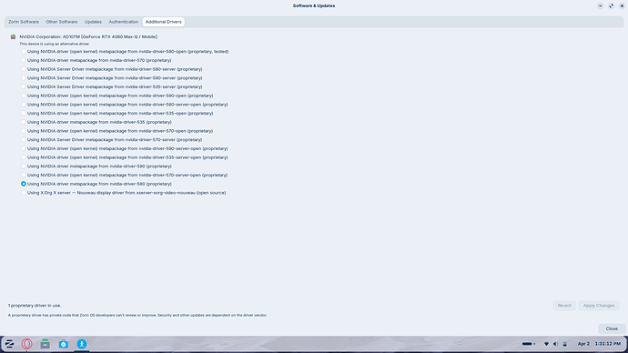

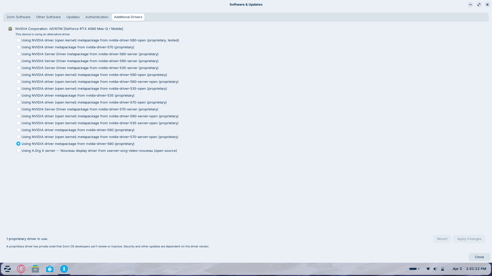

Yeah, I'm aware of it being different on other Laptop models, mine is an 'ASUS TUF GAMING F17' laptop and here's my driver selection. When I installed Zorin OS Core 18 I selected NVIDIA when BOOTING from USB replacing Windows 11 but keeping the same NVIDIA drivers, my CPU/GPU are

" The lack of vibrant colors on Wayland is primarily due to NVIDIA drivers lacking color adjustment features (such as Digital Vibrance, Brightness, and Contrast) that are available in X11 via nvidia-settings .
  • Driver Limitations: The NVIDIA drivers under Wayland currently do not support nvidia-settings options for color adjustments, and the compositor itself does not handle these post-processing tasks by default.
  • Workarounds: Users often apply color changes in an X11 session and retain the settings until a power-off, or they must configure color profiles within the desktop environment (e.g., KDE's color profile options) or use external tools like hyprshade with custom shaders for saturation.

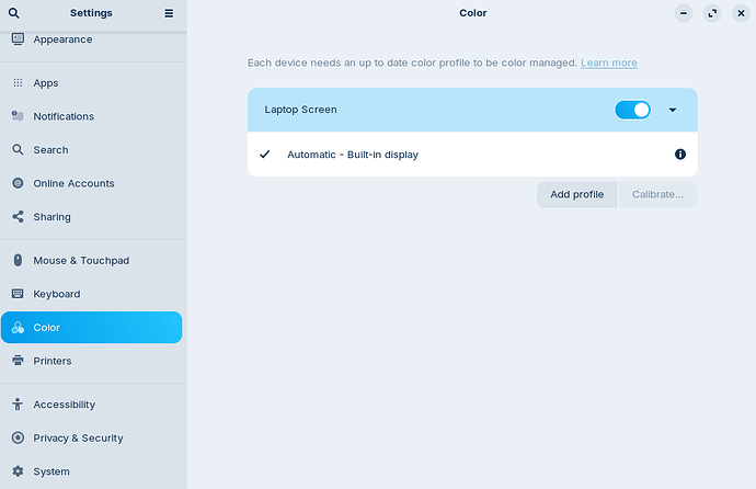

Just to clarify between xorg and Wayland they're infact using the same automatic - built in display.

Hi, it would have been helpful if you labeled the diagrams for clarity. I am guessing the too picture was X11 as the text looks marginally clearer than the bottom one. (Reminded me of a visit to the optician's, "Which is clearer, 1 or 2").
I have never really understood how colour profiles work which are usually limited to Displays and Printers.
Yes you're correct, the top screenshot is 'Zorin Desktop' X11 and the bottom screenshot is 'Zorin Desktop on Wayland' but as of my last reply I said I was focusing on getting Pinch to Zoom gestures working first on X11 'Zorin Desktop' first before creating a second forum post for color profile fix on 'Zorin Desktop on Wayland' I want to make sure I get the Pinch to Zoom gestures working first.
Let me know if you want to see a screenshot of how colors of images look different between X11 and Wayland.

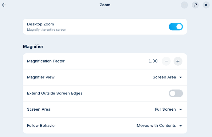

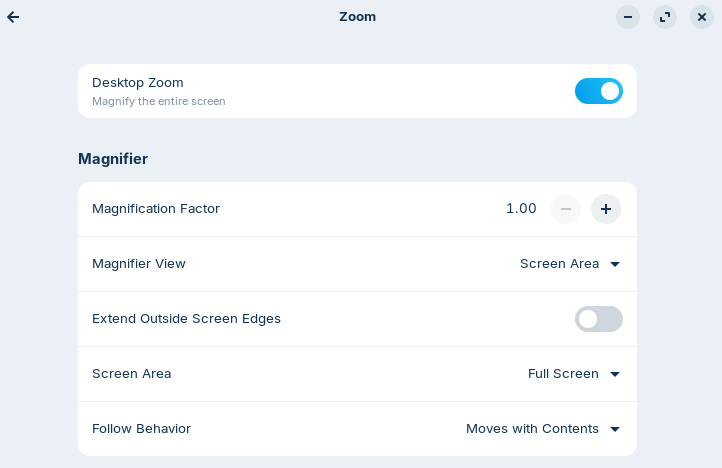

How it works:
Go to Settings > Accessibility > Zoom and set all options to the changes provided in the image below, open your Web Browser and Hold Windows Key + Alt + plus key to zoom in if you want to zoom out just Hold Windows Key + Alt + minus key this works on both X11 and Wayland. although works best on Wayland with Pinch Zoom Gestures.
