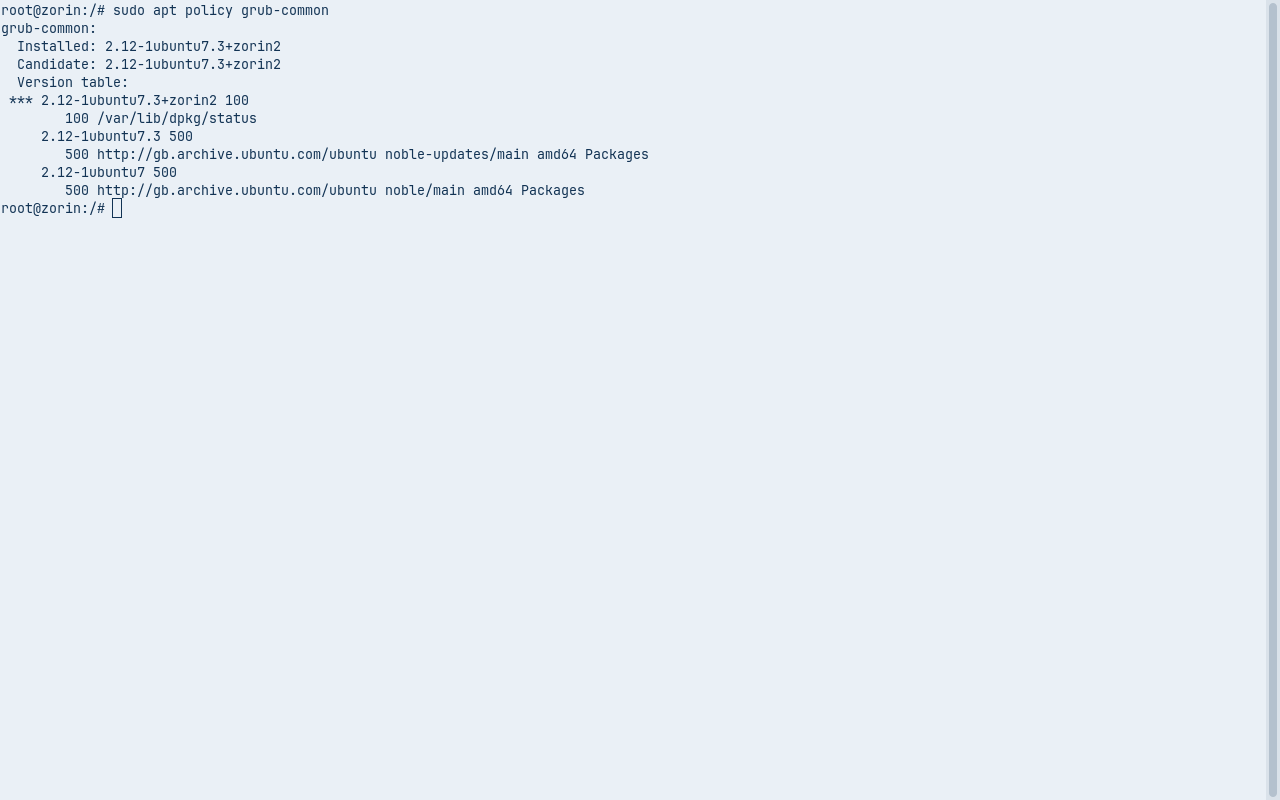

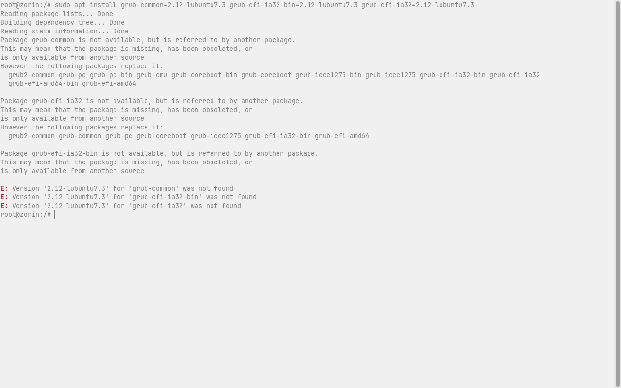

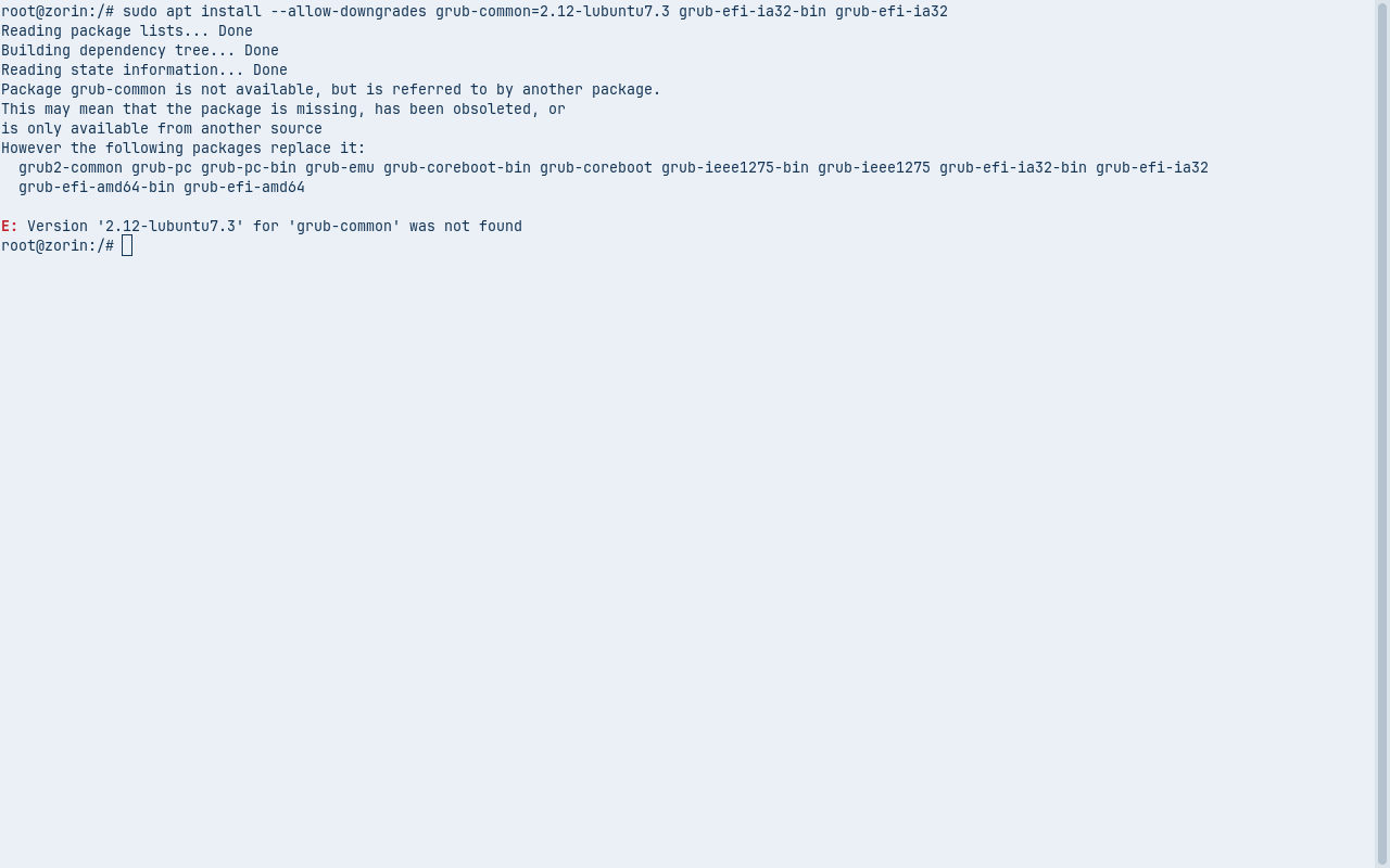

Not there yet.
Commands and output below :-
sudo apt install grub-common=2.12-lubuntu7.3 grub-efi-ia32-bin=2.12-lubuntu7.3 grub-efi-ia32=2.12-lubuntu7.3
apt policy grub-common
sudo apt install --allow-downgrades grub-common=2.12-lubuntu7.3 grub-efi-ia32-bin grub-efi-ia32
Regards
Dave
The version in the Ubuntu repository is 2.12-1ubuntu7.3 (note the 1 before "ubuntu" and it is "ubuntu", not "lubuntu"). My apologies for the confusion in the previous step; these version strings are very specific!
The Corrected Command
Inside your chroot terminal, please run this exact command using the version strings we confirmed from your screenshot:
apt install --allow-downgrades grub-common=2.12-1ubuntu7.3 grub-efi-ia32-bin=2.12-1ubuntu7.3

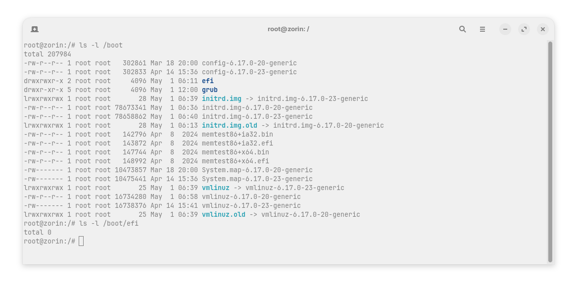

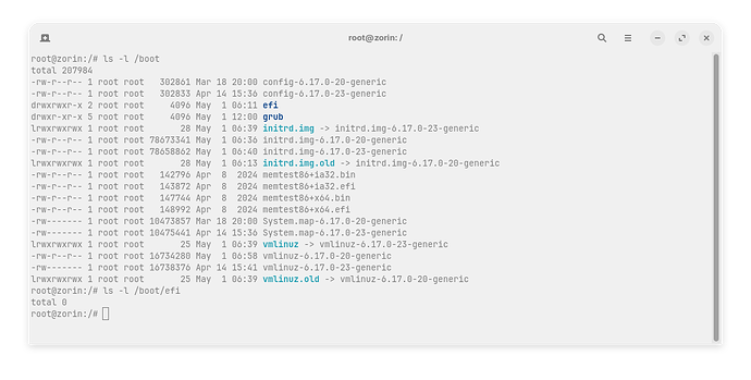

When I run the grub-install command, I get an error saying that /boot/efi does not look like an EFI partition.
This error happened because the EFI partition isn't actually "connected" (mounted) to the folder you're working in. In image_5a3538.png, we can see that ls -l /boot/efi shows total 0. This confirms that the directory is empty because the actual partition is sitting unmounted outside of your current environment.
The Fix: Re-mounting the EFI Partition
Follow these steps exactly in your terminal:
1. Exit the current environment
You are currently "inside" your installed system. We need to go back to the Live USB environment to fix the mount.
exit
2. Identify the EFI partition again
Just to be 100% sure of the name (it’s usually something like /dev/mmcblk0p1 or /dev/sda1):
lsblk
Look for the small partition (100MB-500MB) labeled "EFI" or formatted as FAT32.
3. Mount it to the correct spot
Replace /dev/sdXm with the partition you identified in the previous step:
sudo mount /dev/sdXm /mnt/boot/efi
4. Re-enter your system
sudo chroot /mnt
5. Verify and Run the Install
Now, if you run ls /boot/efi, you should see some files or folders (like an "EFI" folder). If you do, go ahead and run the command that failed before:
grub-install --target=i386-efi --efi-directory=/boot/efi --removable
