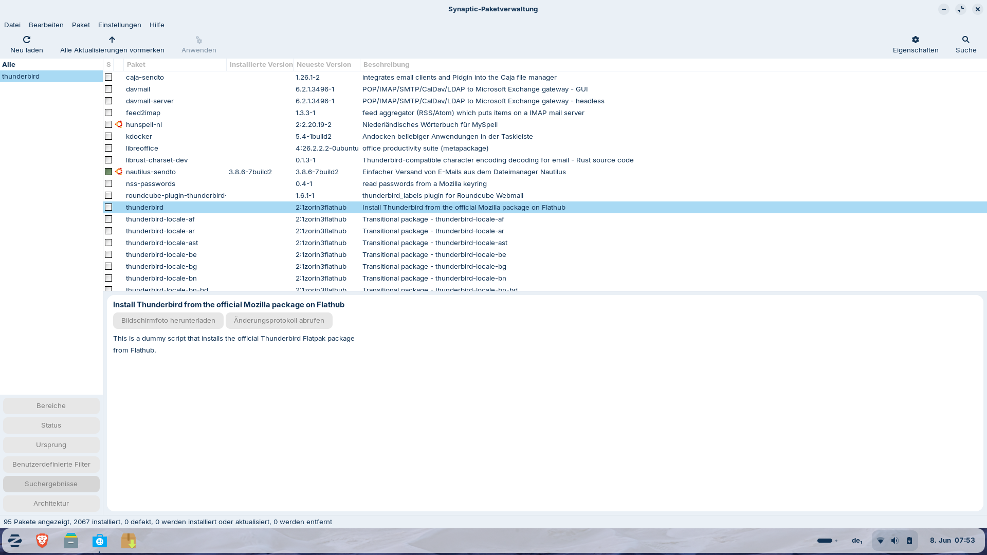

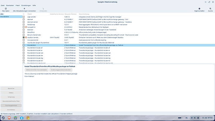

It looks as it is the same as with gnome-software. There is shown that the Thunderbird package is a script which installs the flatpak:
And when you click to select the package to save it for the installation, there is a message that flatpak will be installed before.

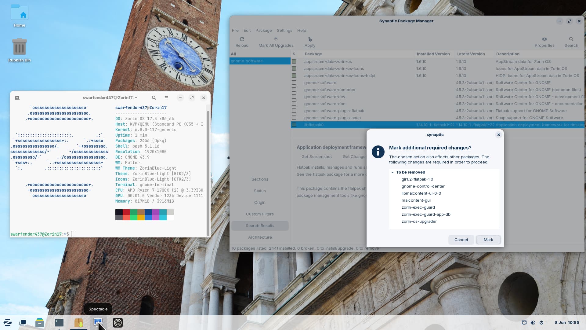

Well here we are. I forgot I had to reinstall gnome-software over a query on a post on the forum. Removed it and can still get into Zorin. What I discovered in Synaptic is that there is still liblflatpak0 - and look what happens if it gets marked for removal! I am beginning to think Zorin is definitely moving towards flatpak for sure:
Oops! That's not good... I also noticed that even though I uninstalled Flatpak, a lot of Flatpak libraries are still installed.
