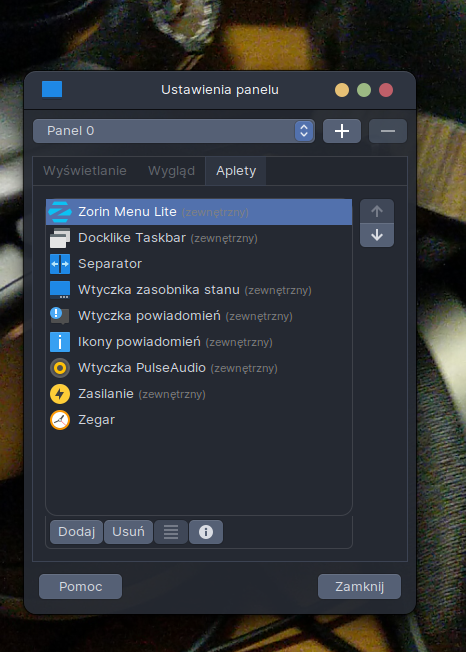

Do you seeing my taskbar menu is very weird double things and some channel RSS kde. I told you here is something weird.
Double volume settings and i don't remember i installing some new taskbar menu.
