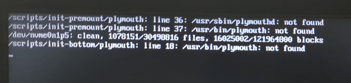

Hey everyone, today when I opened my pc I saw this on boot
/scripts/init-premount/plymouth: line 36: /usr/sbin/plumouthd: not found /scripts/init-premount/plymouth: line /usr/bin/plymouth: not found /dev/numeon1p5: clean, 1078151/30498816 files, 16025002/121964800 blocks /scripts/init-botton/plymouth: line 18: /usr/bin/plumouth: not found
It wasnt fatal, the boot logo apeared afterwards and It booted fine but I want to know if there is any way to scilence it or solve it somehow. Thanks

This is what I actually get during boot
Can someone help me?

Notice this line has a typo (plumouthd, plumouth):
This is why I think the custom theme obtained from Gnome Themes site is the fault carrier.
From the Recovery Menu > Drop to root prompt, you can run
nano /etc/initramfs-tools/scripts/init-premount/plymouth
Look for further plumouth typos and correct them to plymouth

It seems that now it doesnt show this error anymore on boot but i still cannot update initramfs
