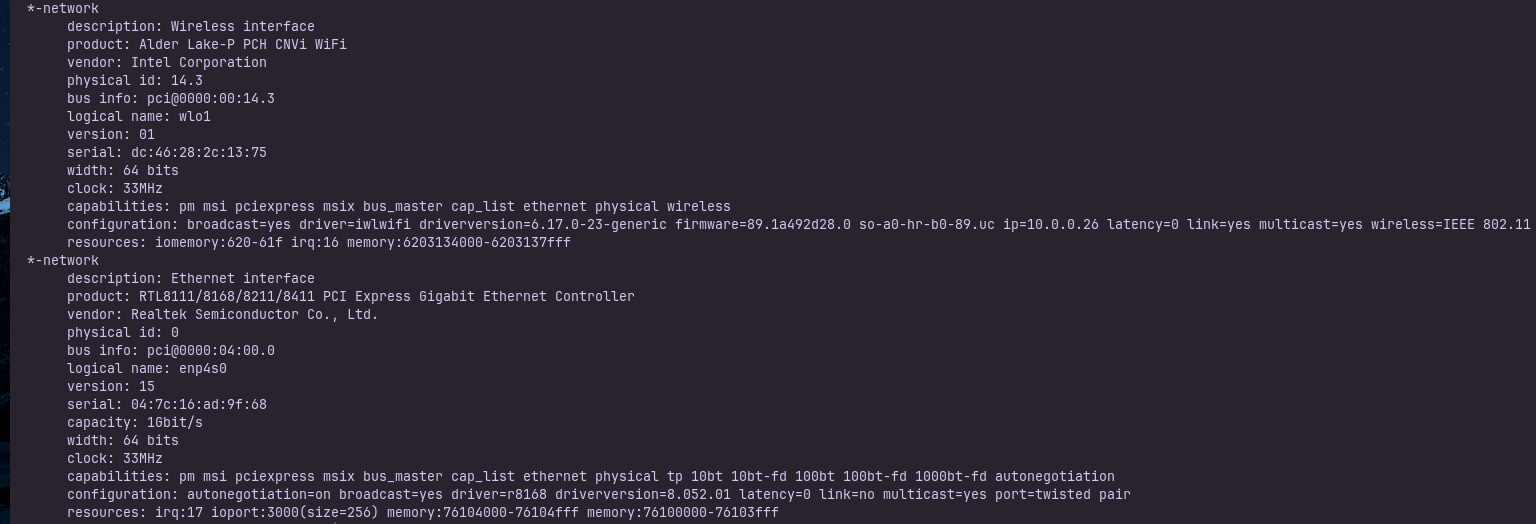

  • Could You post the Output of the Commands sudo lshw -C network and rfkill list please?
Hey thanks for your patience and your response. I don't have Secure boot or fast boot enabled, nor is windows installed. Software & Updates has nothing, I'm using X11 and rfkill list shows no blocked hardware of any kind. As for echo $xdg_session_type I'll attach a screenshot.
I have the same ethernet card as you do and I had to downgrade to an older kernel (6.8 works for me) in order to get it to work.
If you go into the second option in the grub menu you should be able to choose an older kernel and if that works we can help you edit your grub so it saves your choices and defaults to saved.
