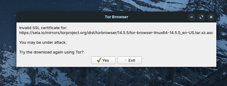

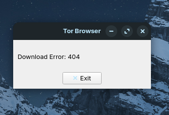

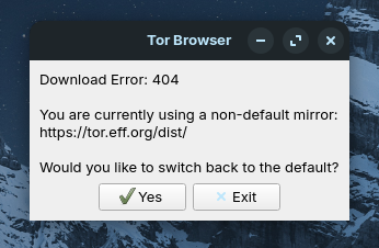

  2. Tor browser, upon first launch it tries to download and all I get are errors no matter which mirror II use with the Tor settings launcher, I finally found a mirror that worked the Tarball downloaded and after over an hour it was still trying to "verify the signature" So I cancelled it, maybe I will install as a Flatpak.
    This was the error message from Tor Project ...
and this from other mirrors ...

The use of the Tor browser is blocked by the government in some countries.

I'm not in China, Russia, Belarus, Iran, North Korea or Venezuela so NOT blocked, maybe always on VPN is causing problems?
Yes, VPN can cause the problems.
I will switch off and try again. This would seem peculiar to me if by design by the Tor Project as it's Tor and for various reasons eg like being in one of the countries listed by me, you might want to hide the fact that you're downloading Tor however this might not be a Tor Project issue(?)
Take a look at VPN notes.

I gave up after trying 10 different mirrors off my VPN with many amusing error messages eg "You may be under attack" and "Not official mirror"
