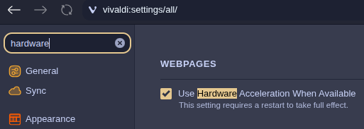

You could try to disable graphics hardware acceleration to see if that makes any difference in some of these apps. In Vivaldi, for instance:

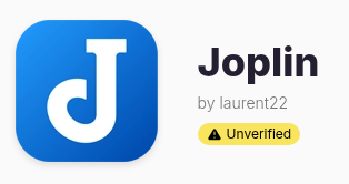

In Linux, there are multiple package formats that you can choose to install applications. Depending on the program, there may be none, one or more available for download in the software store. For example, there are multiple entries for Joplin available:
Unfortunately, deciding which package to install becomes more difficult when we take into account that not all sources are verified:
Even though in this particular case, it looks like this is the author of Joplin, so I'm not sure why it's labeled as such. Which just goes to show the headaches that can arise from the complexity of the package ecosystem in Linux.

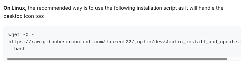

My advice: when you see too many options from many sources, head over to the website and see if there are any instructions or preferred installation method, and use that.
In the case of Joplin, they recommend using their installation script:
You'll need to copy this snippet from their website and paste it into your terminal (you can launch it from the applications menu).
Give this one a try and see if that works out fine.
