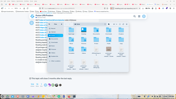

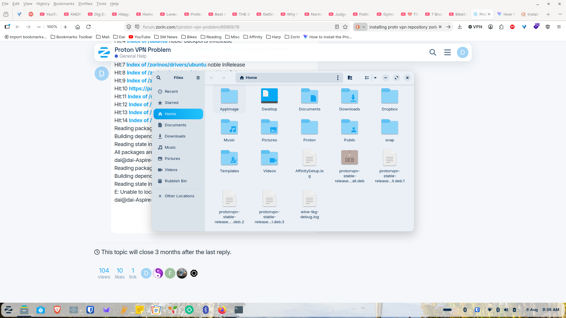

Hm...The repository is not added even when you entered the right commands. I haven't found out the error yet and I'm going to test it.
Did you check the integrity of the downloaded file with the second command? There should be shown OK, if not, remove the .deb file and download it again.
I tried it with the same commands, and for me it worked, and the repo is shown afterwards.
Do you have the file "protonvpn-stable.sources" at /etc/apt/sources.list.d"?
What is the content of the file?
