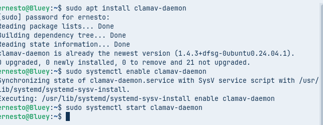

I would like to set up regular scanning and I believe the ClamAV-Daemon and ScannerClient are needed. I see them as "not installed" under the components section of settings. I have ran through the terminal commands given there to install and they seem to step through things fine.
But they still report as "Not Installed" and I do not see any changes in ClamUI to show any ability to schedule regular scans.

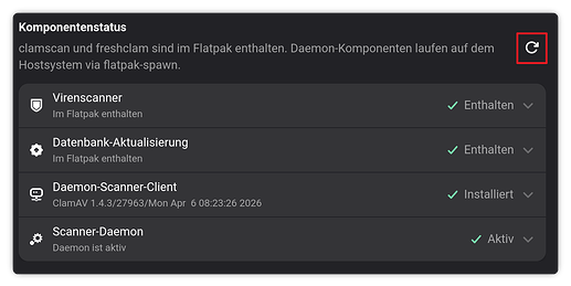

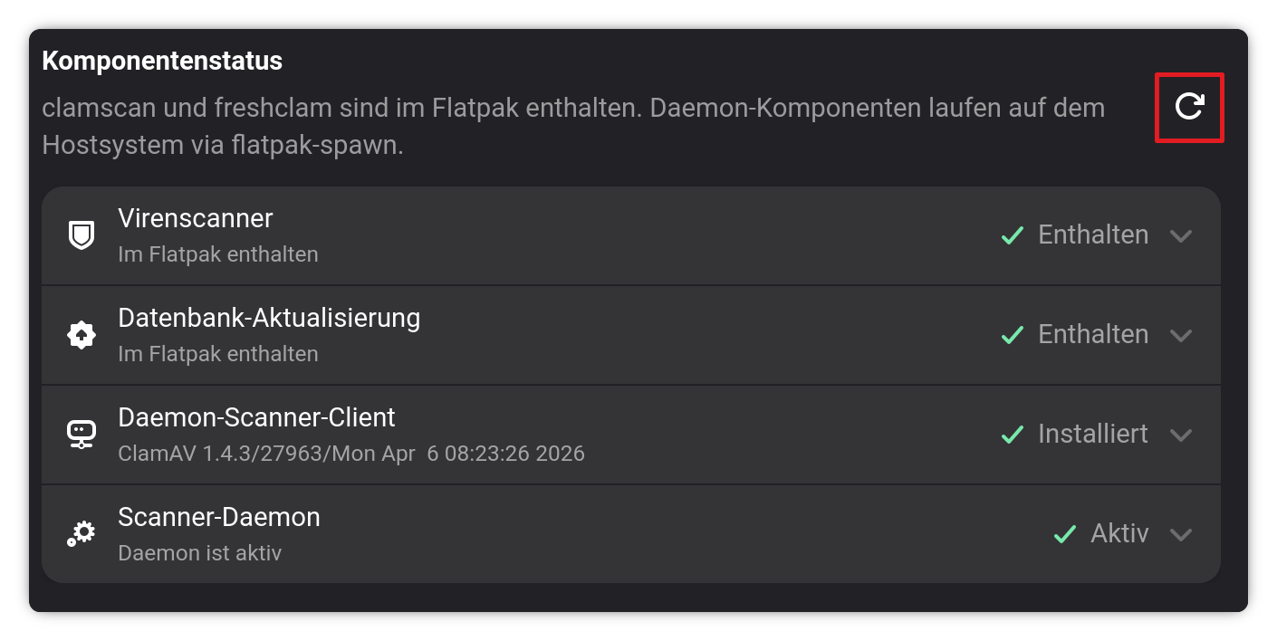

Try it with a Reboot. Also there is a Reload Button what You can click on:

I will try both ideas. But in the meantime I found running the following on the terminal helped:
sudo touch /var/log/clamav/clamav.log
but I also thought to Quit ClamAV from the system-tray and restart it. Now the components indicate as installed. But then maybe all I had to do was to restart the thing and did not need the log folder command OR as Ponce said: Reload!

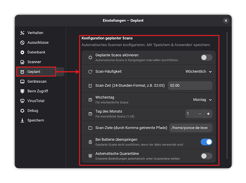

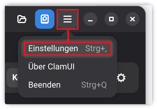

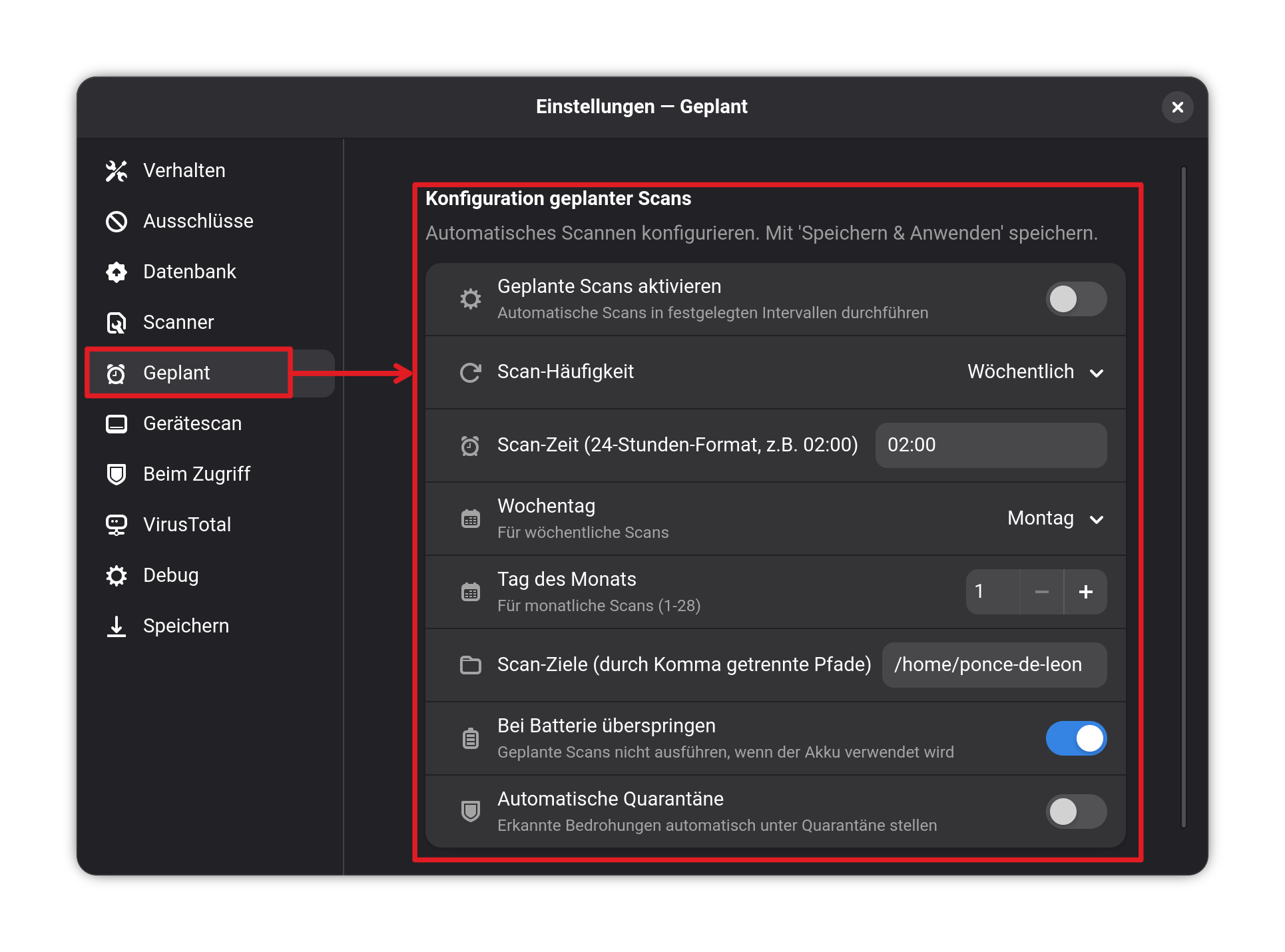

Next I will try out your idea to see if I see any controls that will allow automated scheduled scans.
That, You can find in the Settings:
