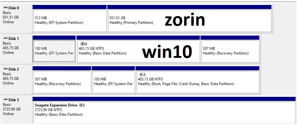

So this is probably the issue I'm having in this thread then?!
*hopefully this is of use to the OP as well as we seem to be wanting the same setup
Hmm, Disk 0 has a good sized EFI partition.
1,2 however, only have 100 megs, which is too small. Which of these three is the one actually holding your bootloaders?
The top one is the zorin disk, second one the windows 10 install (the m2 "c drive"). Next one is just data (not sure why theres an EFI on there tbh - its just art files and music), last one is a backup external drive.
Edit: sorry! had some cat problems there.
Not sure which one but I assume the win 10 drive.
