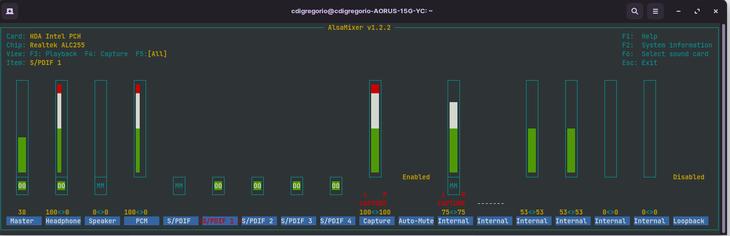

This is what is showing withing alsamixer
In alsamixer try toggling [Loopback] and see if that has any effect.
You can also try same with [Auto-Mute].
I see 3 channels marked as Muted i.e. MM. Unmute them by selecting the channel and typing M.
From experience, sound issues often involve trial and error experiments.
Still no luck unfortunately, I unmuted them and enabled, but it still isn't listing the microphone as an input option
