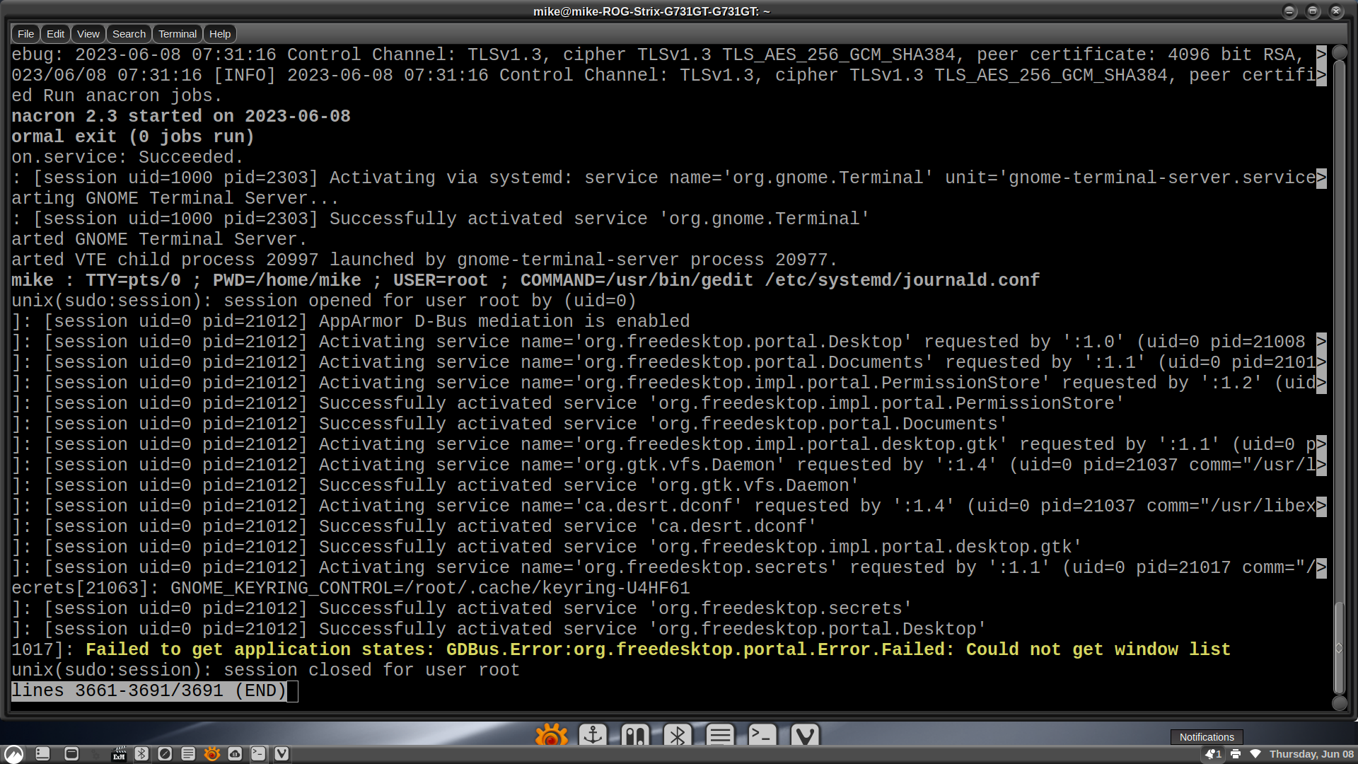

OK ..... I did the ..... #SystemMaxUse=100M will limit the file size to 100 Mb ..... and ran ..... journalctl -b ..... again and nothing changed so I took some photos to show today's log ..... but only the 1st and last page as there i just way to much info ..... and the entries are VERY long but I did copy the first and last in their entirety if you want to read them ....
