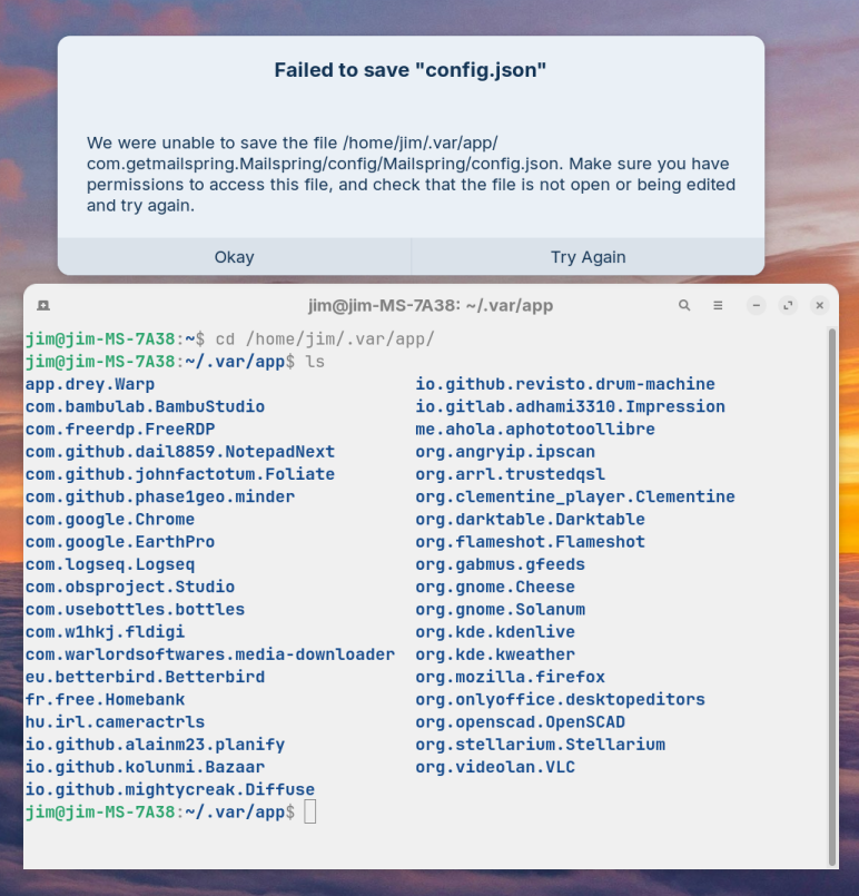

Using ZorinPro 18.1. I installed and then deleted Mailspring as my email reader. I now get an error popup as shown in the attached screen cap. I have tried to follow the error instruction, but am not able to rectify the problem. The attached pic also shows the appropriate /home directory contents: no com. reference to Mainspring.
I am not a PC Wiz, so am not sure what direction to take in solving the problem. Please help with any suggestions or solutions. Thank you for any help.

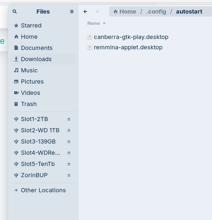

Hmmm.... If it doesn't show up in the tool above, the file is likely hiding in a hidden directory. Even though you checked your /home folder, these files are often inside a hidden folder called .config.
Open your Files (Nautilus).
Go to your Home folder.
Press Ctrl + H on your keyboard. This reveals hidden folders (they all start with a dot).
Navigate to: .config -> autostart
Look for a file named mailspring.desktop or anything containing "mailspring".
Right-click and Delete that file.
Have you rebooted since you removed the application?
No hidden Mainspring files in this directory.
