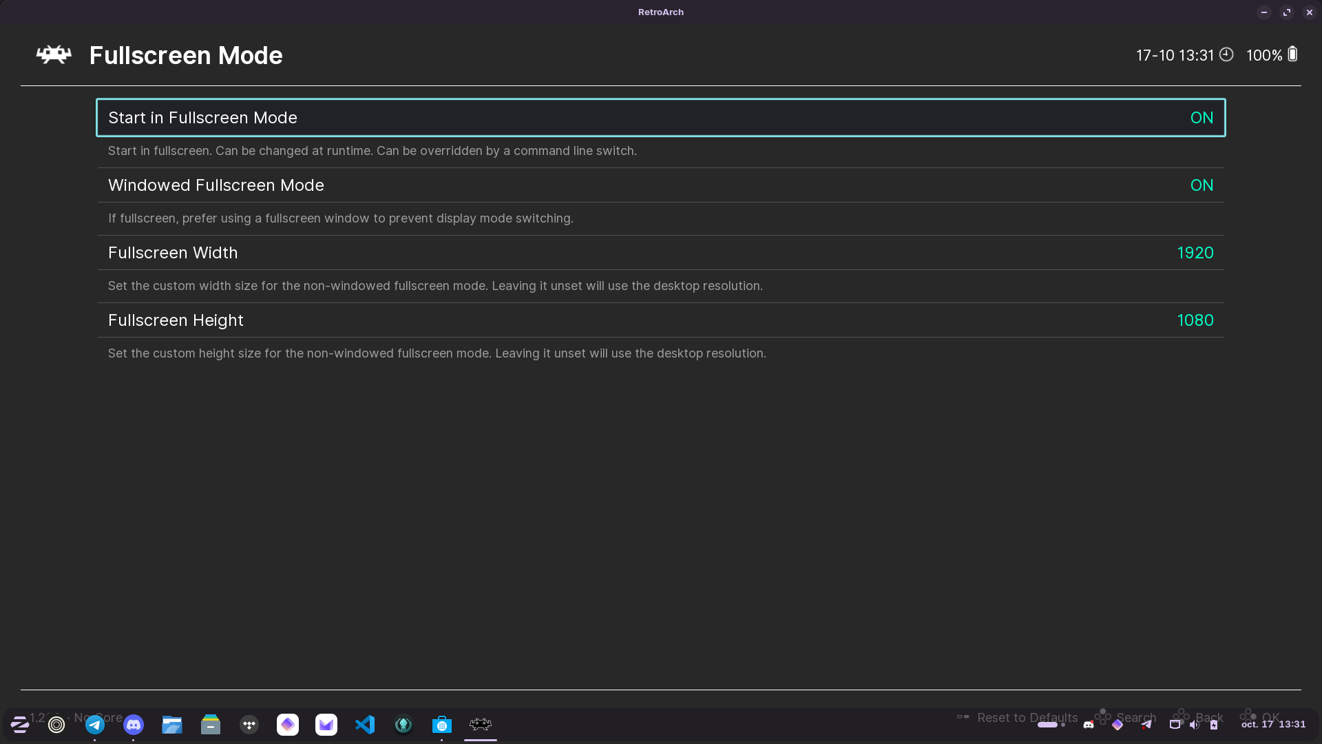

Hi! I just installed the verified flatpak package from the software manager for RetroArch, and the fullscreen mode won't take up the entire screen estate, whether in borderless or true fullscreen mode. The taskbar also won't go away for some reason. This doesn't happen in other games running through Steam or Lutris. What gives, and how does one fix these two issues?

Please disable "Windowed Full Screen."
Also, make sure your Fullscreen Width & Height, are set at your correct screen resolution.
